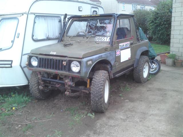

on the front wings (if you havent welded them back up yet)
why not cut another inch out.
that will then allow you to run even taller tyres in the future without having to re mod them.
have a look what i have just done on d86 to get what i mean...
just a thought..
tony :P
see the arch is cut 1/2 inch over  the the original body/arch swage..

Too late for that now. Its all tacked back together, just gotta put a couple of plates in behind where the head lights are then its sorted. Apart from bashing the bent bits roughly back into shape. The arch extensions are 4.5inches and just come out to the edge of the tread. Once i edge them they will be just short of the tyre wall, which i've been led to believe is 100% legal

Chopped a bit more off and shaped the wings. Its looking good so far. Aiming to hav it ready for Mad Frickley in June.

Few more pics of those spectacular new arches, you can't see it too well in the pics but i've edged them with sum 4mm rod.
Thats it for the weekend i think now. Next weekend i'm gona try n get the fuel tank mounted and replace all the fuel lines. I still have a few small holes in the body work to patch. Other than that i think its a matter of going round with the grinder and tidying up some edges and a few bits to weld up properly.
