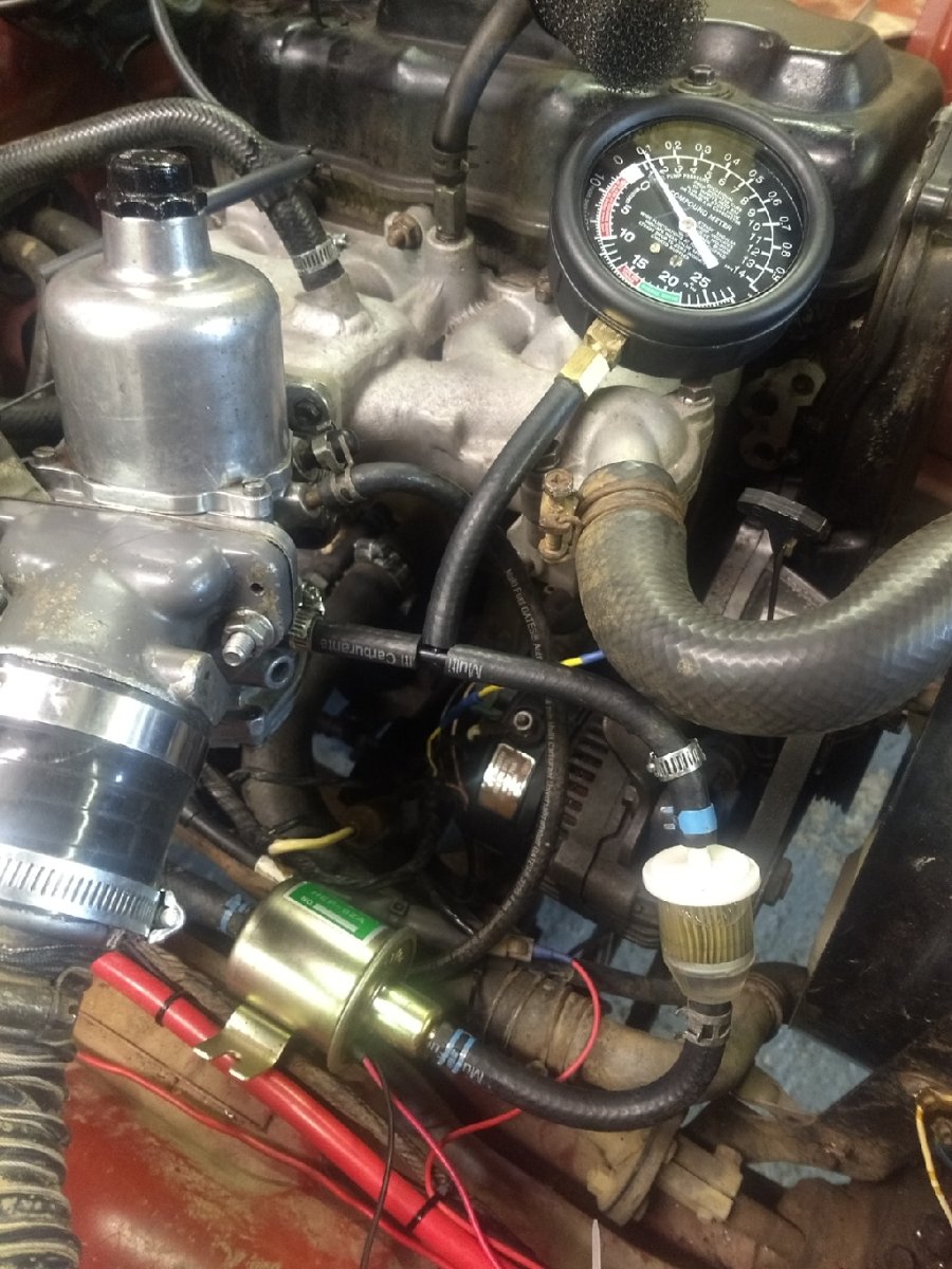

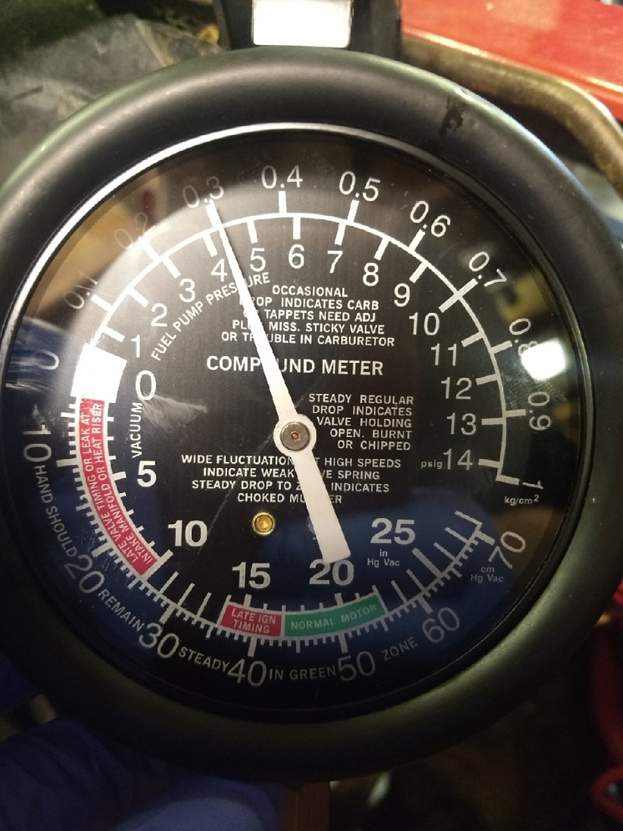

I've also bought a pressure gauge for checking fuel and vacuum. Fuel pressure measuring at just over 4psi at 12.6v and as high as 5 when engine on and blipping throttle. I'm gonna buy a regulator to trim it back to between 2 and 3 psi, see if that makes a difference.

Rather than order a pressure regulator to go with the cheap pump I have, I've decided to buy a better quality pump that puts out a slightly lower pressure.
https://www.ebay.co.uk/itm/FUEL-PUMP-EL ... 890.l49292
Should have it by the weekend, will wait and see what that does.

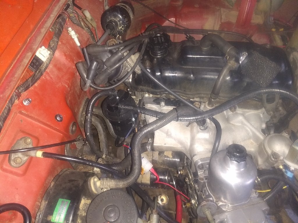

Huco fuel pump fitted. Made a bracket to hang it off the back of the intake manifold so it's tucked in out of the way against the bulkhead.
Only had time to give it a very quick run but it looks to be an improvement. Need to get it proper hot to be certain.
Pump seems like a good quality unit. It must have a built in regulator as it only kicks in when it needs to. It barely runs at idle but ticks away much faster when holding the throttle open.

Hopefully that's cured it. Very tidy engine bay there!
