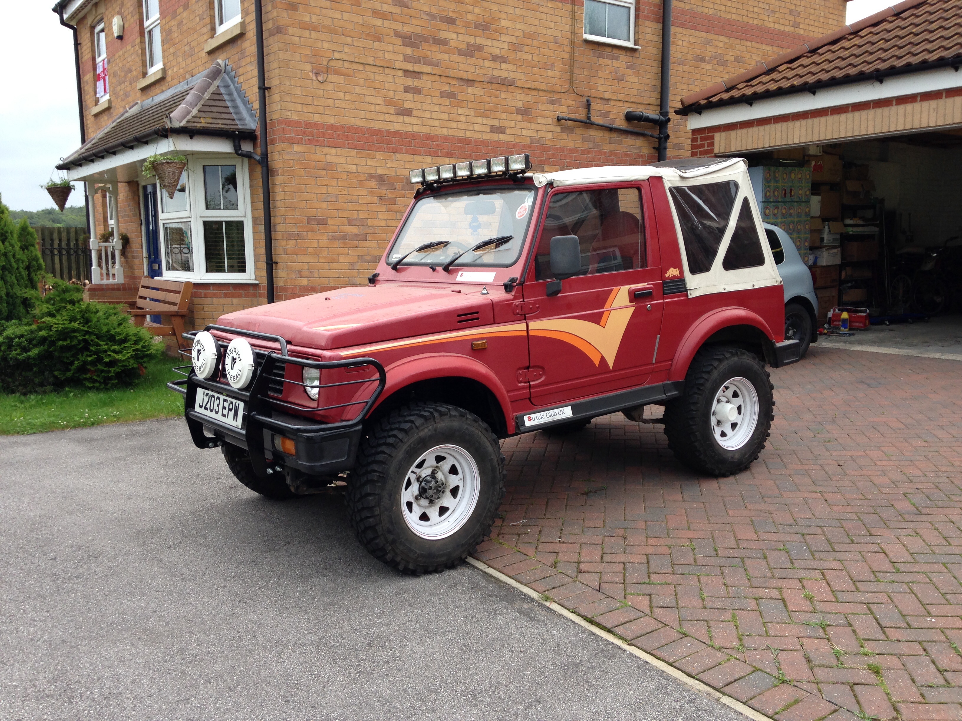

Post by Tramp » Sun Jun 15, 2014 12:26 pm
I bled the breaks as best I could by my self, to be honest they seemed to bleed themselves pretty well just from the pressure in the master cylinder, they work and stop now! I fitted my new 175 needle valve into my weber to stop it stalling going don hills, it was pretty straight forward apart from I lost a piece of the choke mechanism :screwy: but it's running well now and I certainly didn't drive it around the block to see how it goes, I set my weber float heights at 35mm closed to 50mm open,
Sorted :thumbup:

Post by twiss » Tue Jun 17, 2014 10:21 pm
Looking good!
