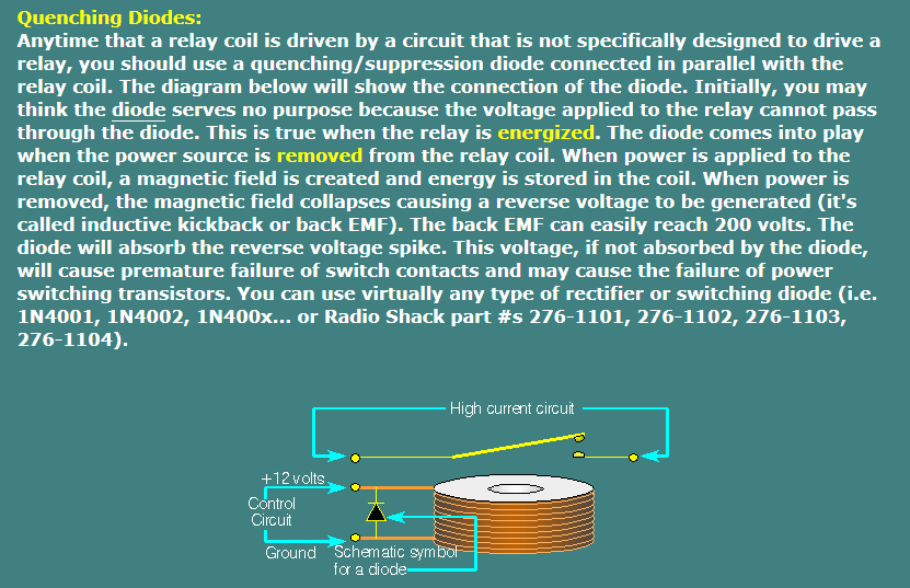

That diode in the relay won't help I'm affraid :cry:
http://www.bcae1.com/relays.htm
