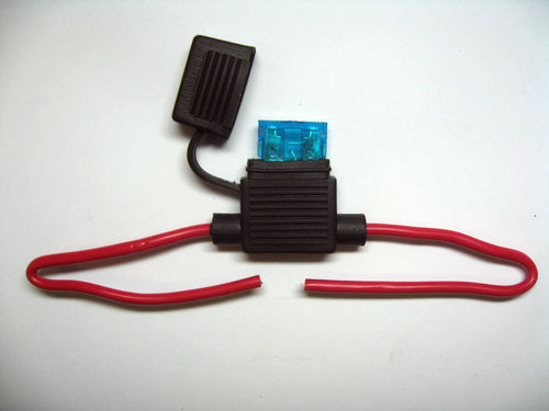

Well it certainly needs cleaning up or at worse disconnect the wires from the plug and connect a external fuse holder.

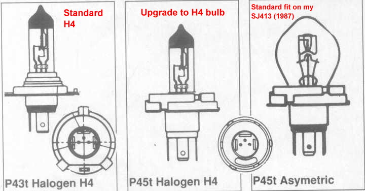

Post by Tramp » Sun Jun 24, 2012 9:06 pm
I had 80w/100 too! They should be 410 45w/40 you can get them from most auto shops

Post by Darrell » Sun Jun 24, 2012 9:14 pm
You can get 55/60 halogens that will fit. These use a little more current than standard bulbs but are not normally a problem. Fitted them to mine many years back :thumbup:
