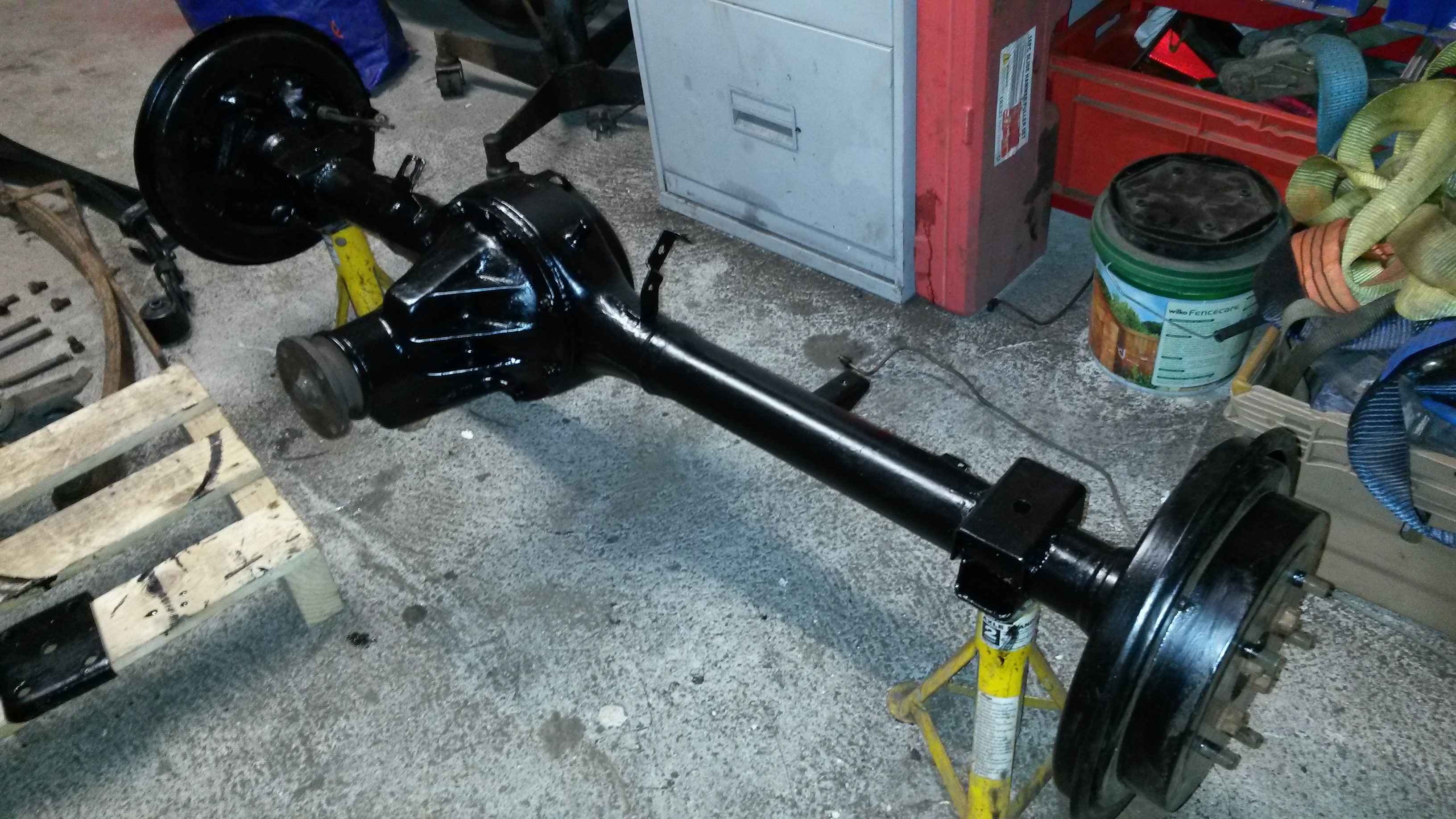

Had a productive day. Got spring perches welded on rear axle and then while it was off thought it would be rude not to give it a good going over with a flappy disc and a lick of good old hammerite.
Then stripped and rebuilt back brakes ready for going back on.
