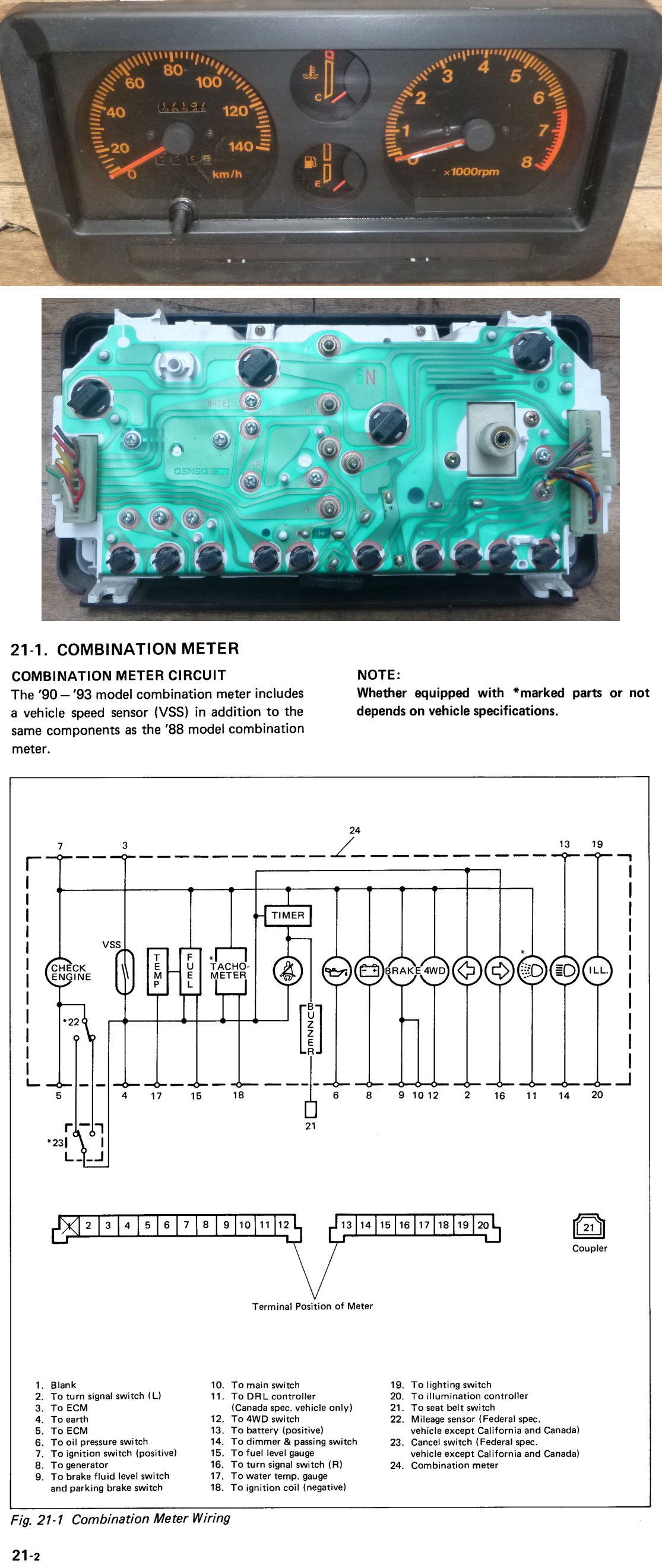

Would anyone have a pinnouts diagram for these clocks?
Re: Wiring diagrams
Post by Darrell » Thu Sep 29, 2016 11:01 am
I've put this together for the type with the VSS, I believe earlier ones would still look the same.
