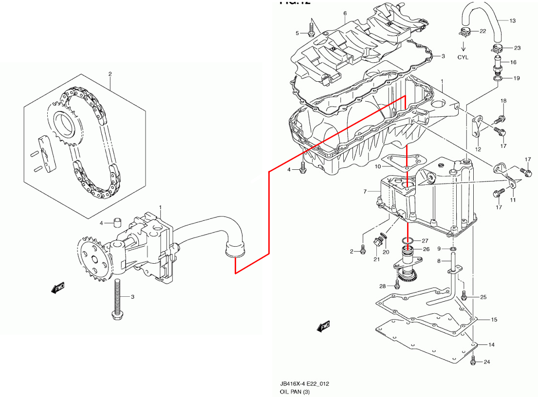

I know sod all about this engine, but have extracted the lubrication section from the manual
in case there's anything in it that may help.
http://s794.photobucket.com/user/Darrel ... s/gv%20oil
I think you may well be correct that the oil pick up pipe from the pump is different.
oil pump.png (382.88 KiB) Viewed 11558 times

Thanks @Darrell - Thats a different diagram to the one's I have seen, and it looks like the setup that I need !
@chan I hope you are right, as this will be my next attack - unbolt the current one, and source this extended hose, which would be a stealer jobbie .

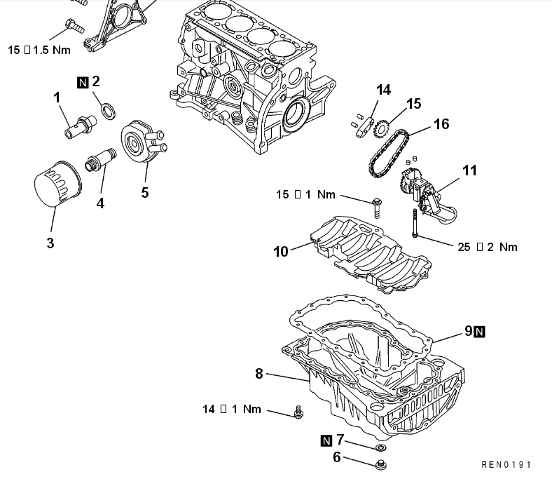

So I went to "Wikipedia" and its fitted to
f9q vehicals.png (23.67 KiB) Viewed 11498 times
So I tried "f9q Mitsubishi"
Found a pdf file on the engine and it shows this
So it looks like you may need the dam oil pump as well as there only shown as one part.
