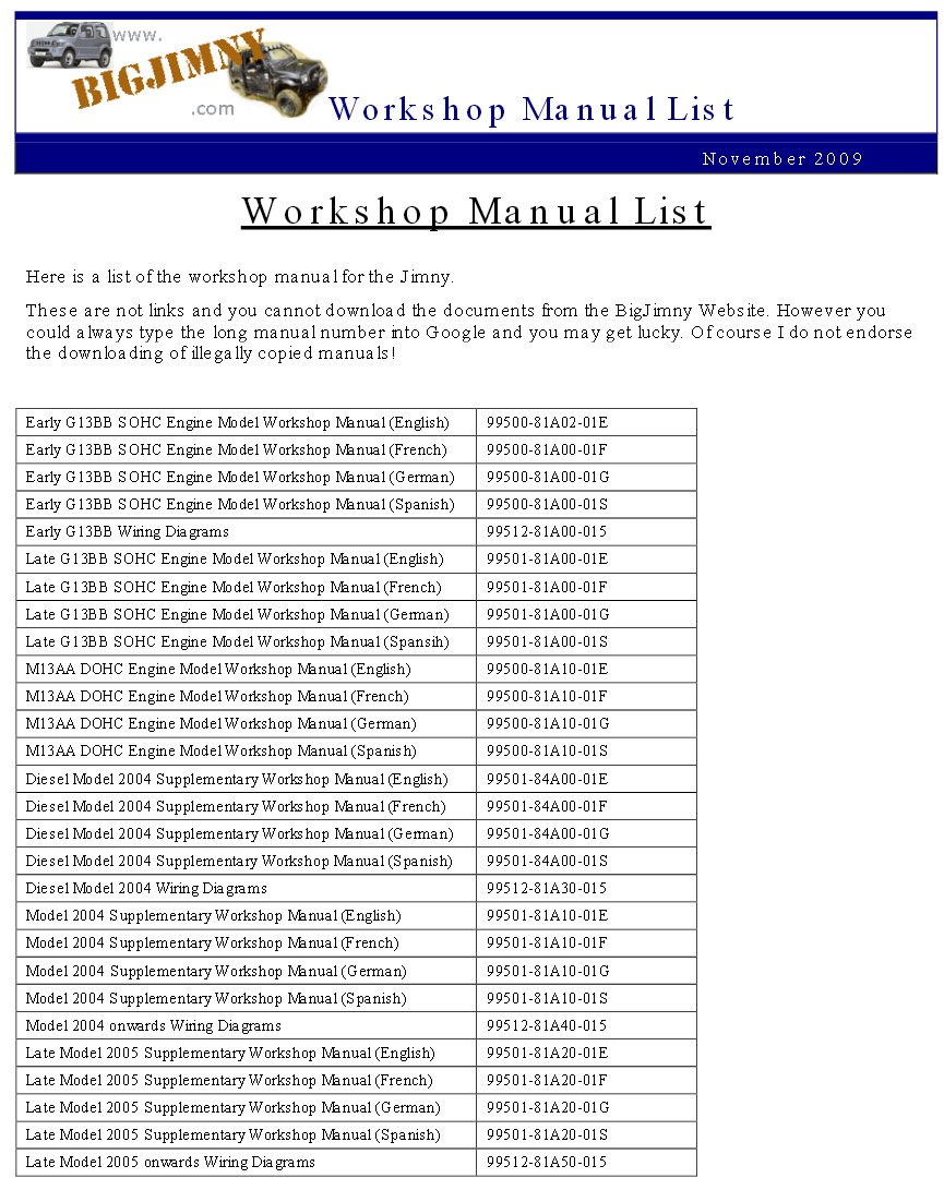

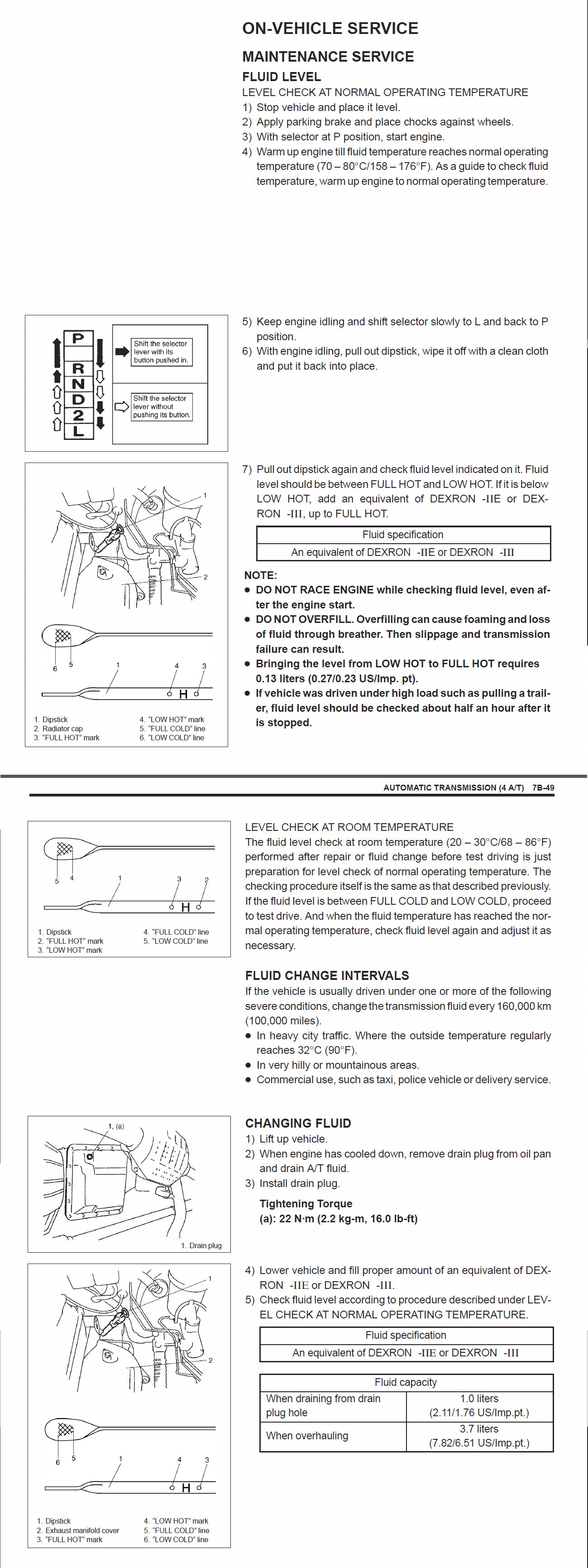

I've only got one workshop manual 99501-81a00-01e
I've robbed the section from it ... but I don't know what years it covers?
Also some info from Bigjimny
Hope it helps..
As said I don't think we got the jimny until about 1998 :er:
I don't think the jimny ever had the G13BA engine :er:
Hell ,what do I know :S :S
