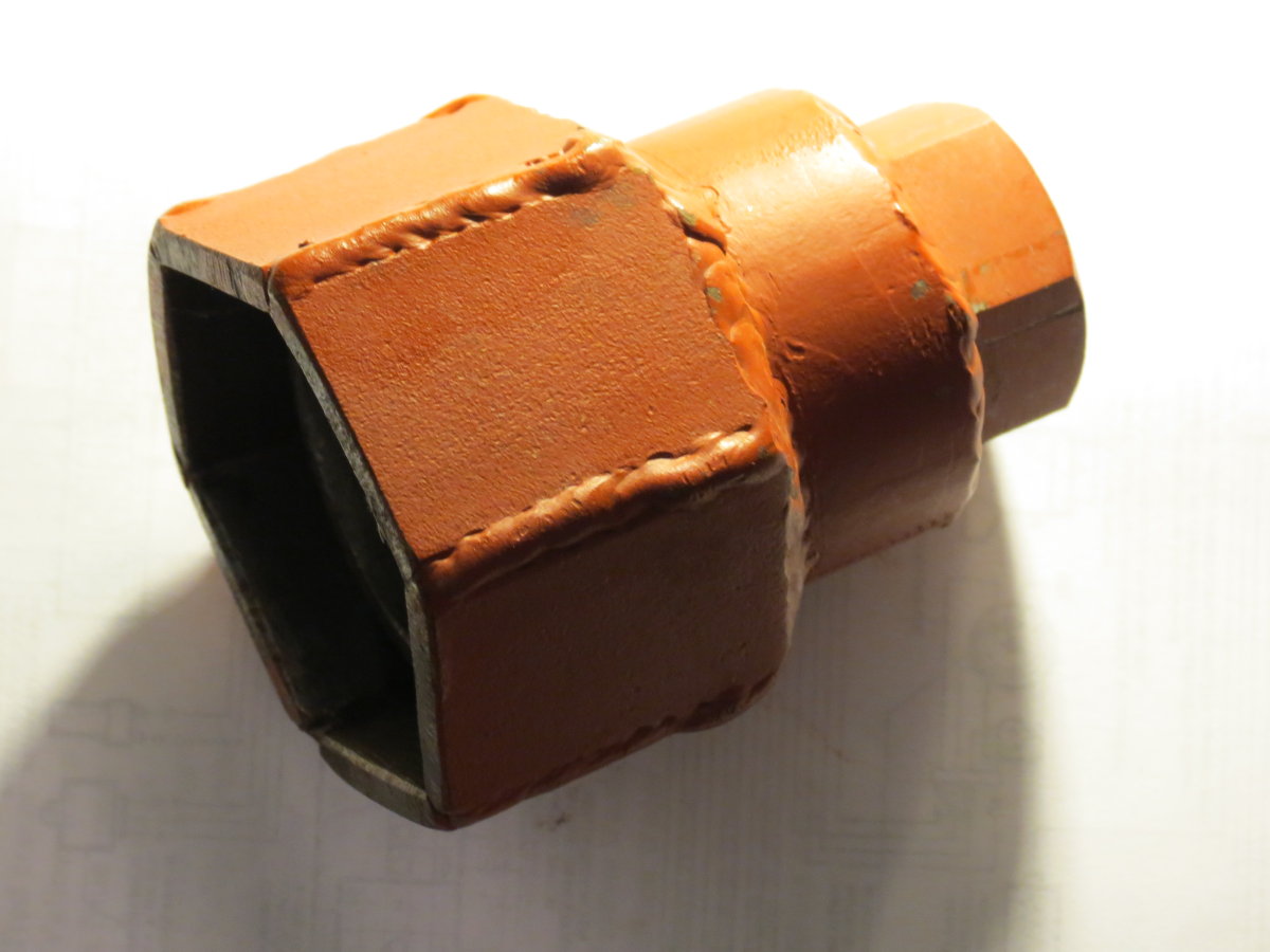

With great certainty I can tell you that the inner and outer nuts are 50mm socket size - BUT, as has already been pointed out, you will struggle to find a socket that has enough depth to allow it to correctly fit over the inner nut because it will bottom on the drive shaft and therefore not reach the nut. This prevents you from torque loading the nut which is essential.
Do what I did, buy a 50mm socket and get it cut in half across its diameter, find a piece of steel tube (I used a section of scaffold tube) and weld an extension so that the upper section of the socket and the bottom section have the tube sandwiched inbetween the two. As I no longer own my sj410 anymore, I sold the socket on this forum to a member in Cyprus.

Or be a right tight git like me and knock up your own !! Well I'm impatient as well, sod ordering one, I needed it now ;)

Darrell, I'm impatient to, wish i could weld that well to make up socket, good work.
