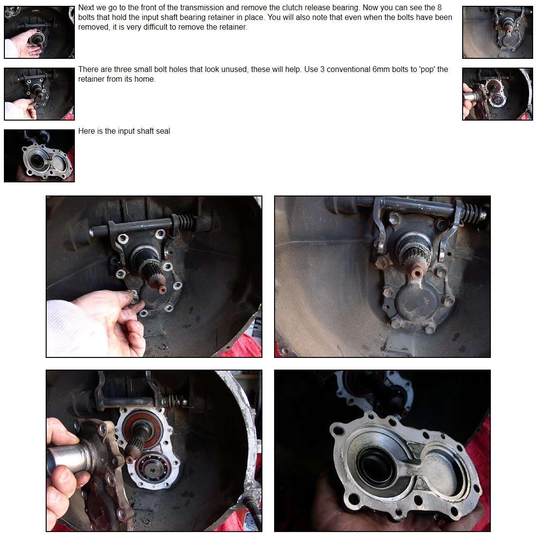

Post by Darrell » Mon Jul 01, 2013 7:08 pm
I want to know why the input shaft bearing is rubber sealed, no wonder they make a noise if they get sod all oil :er: :er: I doubt they seals help keep oil in :er: :er:
Some info robbed from another site. :thumbup:

Post by Jordi » Mon Jul 01, 2013 7:14 pm
Now thats a diagram/set of photos i can work with. Cheers Darrell.

Post by Jordi » Mon Jul 01, 2013 9:21 pm
Just took a second look at that and it might not be oil seal at all. Could just be the sealant around the cover and oil coming out of the countershaft bearing.
I'm intrigued now. Be interesting to see what state its in when i get it off.
