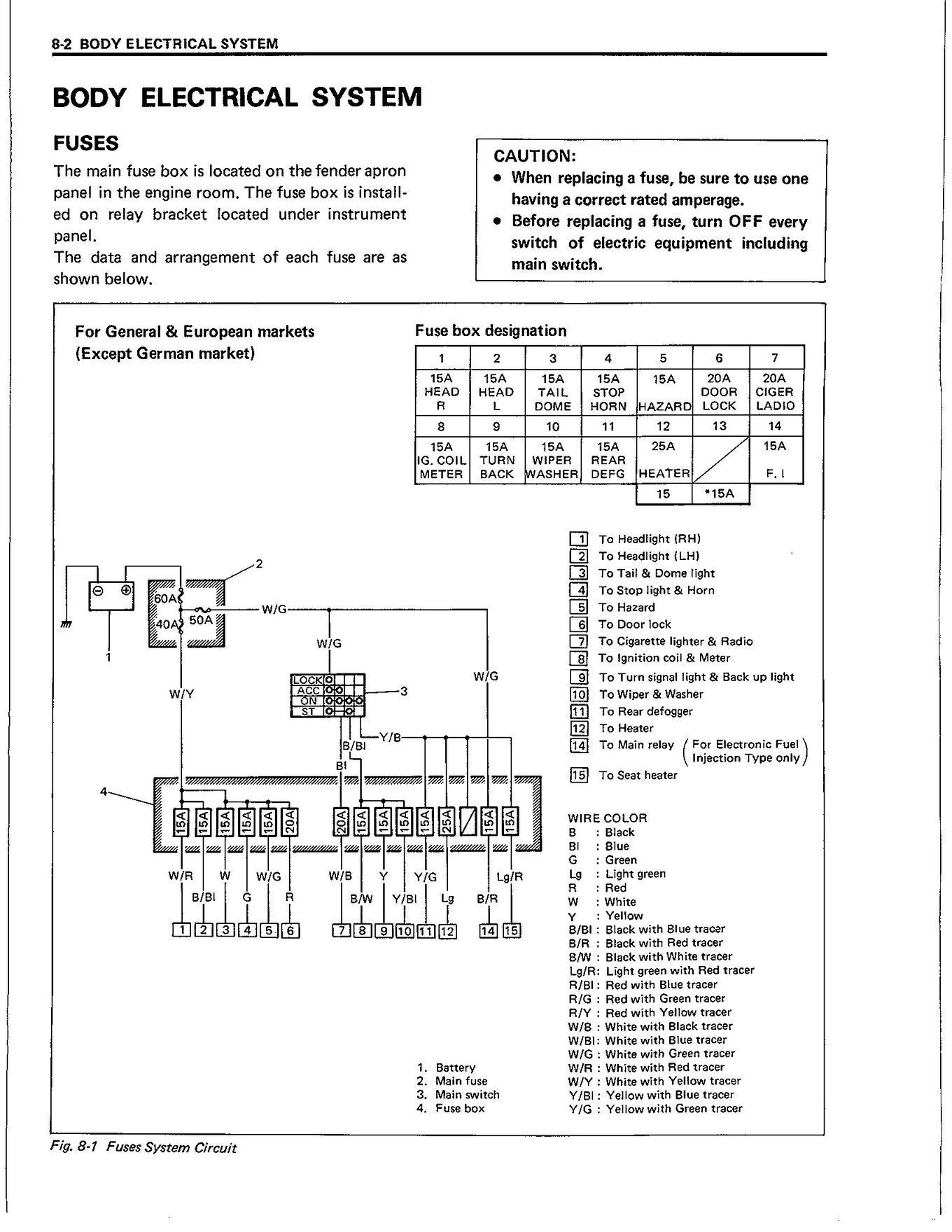

Has anyone got a picture or a diagram of a Vitara fuse box cover? Can't find one anywhere and I'd like to know what the fuses do!

Got this from the 1994 workshop manual so only the 8v.

nice one!
