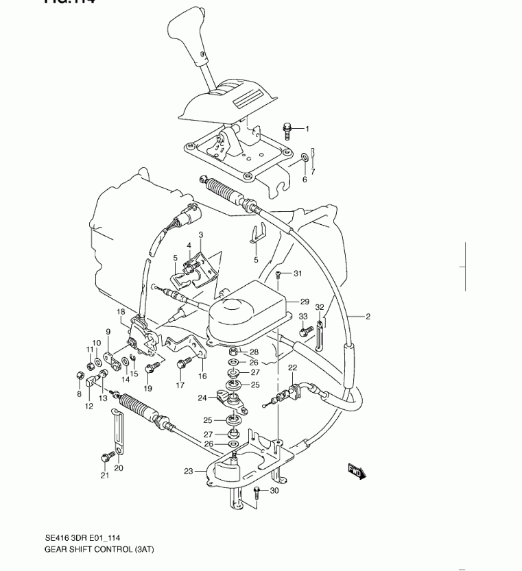

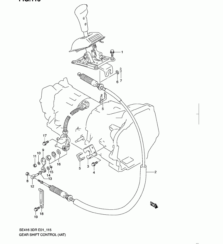

hi have had a look around for a topic on this but haven't come across any ... just wondering whether anyone has body lifted a automatic suzuki vitara JLX.. I'm gonna do it with box section but someone said to me today that because the automatic gear shift is rods i might not be able to do it, any information wil be appreciated! thanks

I admit I know sod all about the automatic gearbox in a vit :oops: , but having a look at the diagrams it shows the lever to gearbox as a cable (this would need verifying) . If this is the case I would expect the cable to have enough movement to handle a bodylift. Also any switches on the lever would probably have enough slack to handle a 2" lift.
at trans 4at.gif (37.3 KiB) Viewed 8528 times
at trans.gif (42.29 KiB) Viewed 8528 times
4AT - 3AT ??? No idea, gears maybe :er:
Hope it's some help.
