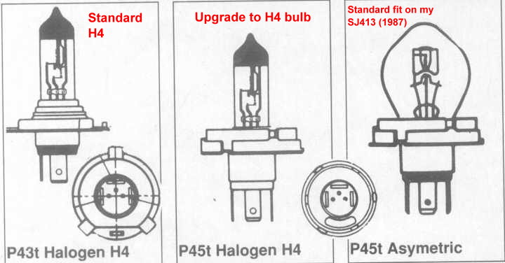

Now why does it say they will fit. The headlamps take p45t don't they
However you can get upgraded bulbs with this old backplate/fitting which are much the same as those.
Just make sure your headlamps will take H4 before ordering as mine is a 1987 and newer ones may well take H4.

I know that the bulbs in my truck are H4s with a T45 fitting. You could probably patch the T45 fitting onto a different bulb using a dremel and soldering it on. You'd just have to be careful that they were central, square and correctly orientated.
Re: i need new headlight bulbs
- Untitled - 2.jpg (43.05 KiB) Viewed 6135 times

Alright, scratch that. Just buy ones with the T45 fitting.
