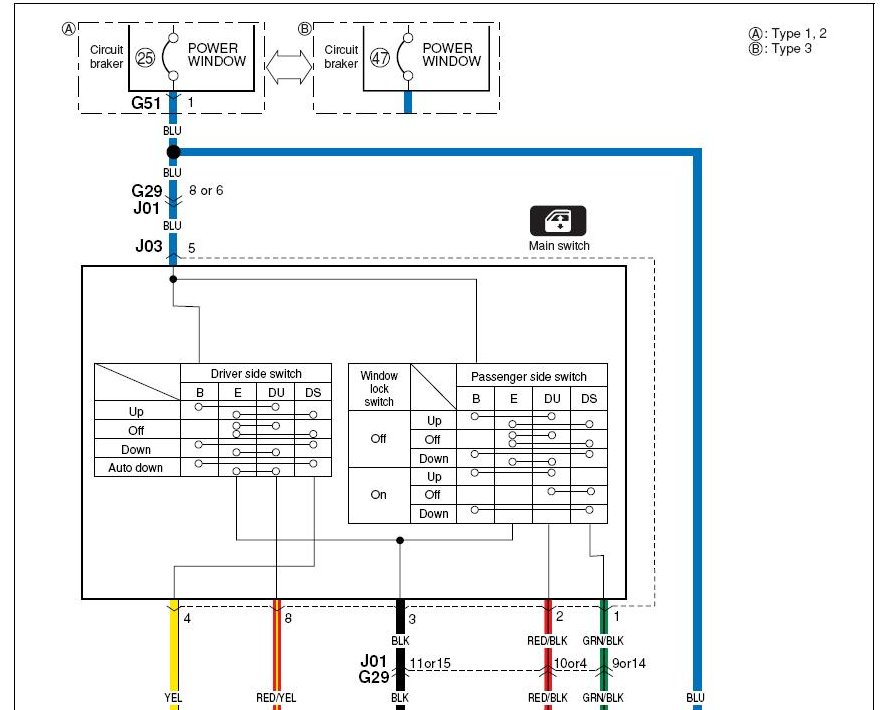

Hi my mums jimny passenger window doesnt operate from either switch
Lights dont dim or anything when button pressed which says to me no current is been drawn
Removed door panel tested voltage at 2 pin connector to motor - 0.3v upon switch activation
Checked voltages at passenger door switch with switch connected
5 pin switch -
big blue wire in middle - 11.8v constant voltage irespective of switch activity
With switch in off state all other pins- 0v
With switch on on any other pin - 11.8v
This to me says that there is no earth path, im not sure which pin is the earth as i have no diagram.
Resistance in wiring between switch and motor is 0.1ohm so ok
due to the voltage drop test, the fact that im getting 11.8v on all the pins when switch is active says that the earth is going through the meter rather than to ground
Anyone got a diagram or know which wire i should be tracing ?

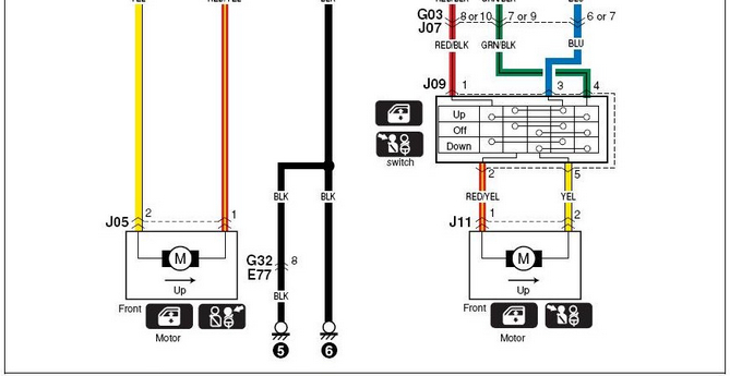

Well it took me a while to find, but here goes.............
win 1.JPG (87.16 KiB) Viewed 5591 times

Thanks brother looks like the earth comes from somewhere else so il have to have a closer look at it later

I tested the wiring again now i know how it works and everything is working fine
So i powered up the motor using jump leads and sections of wire as i dont have a power probe, motor works
Conneted the switch again to see if it was just a sticking motor, still not working :(
PRESSED THE WINDOW LOCK BUTTON NEXT TO THE DRIVERS SWITCH PACK, SURPRISE SURPRISE...IT WORKS :argh:
thanks mum :screwy:
