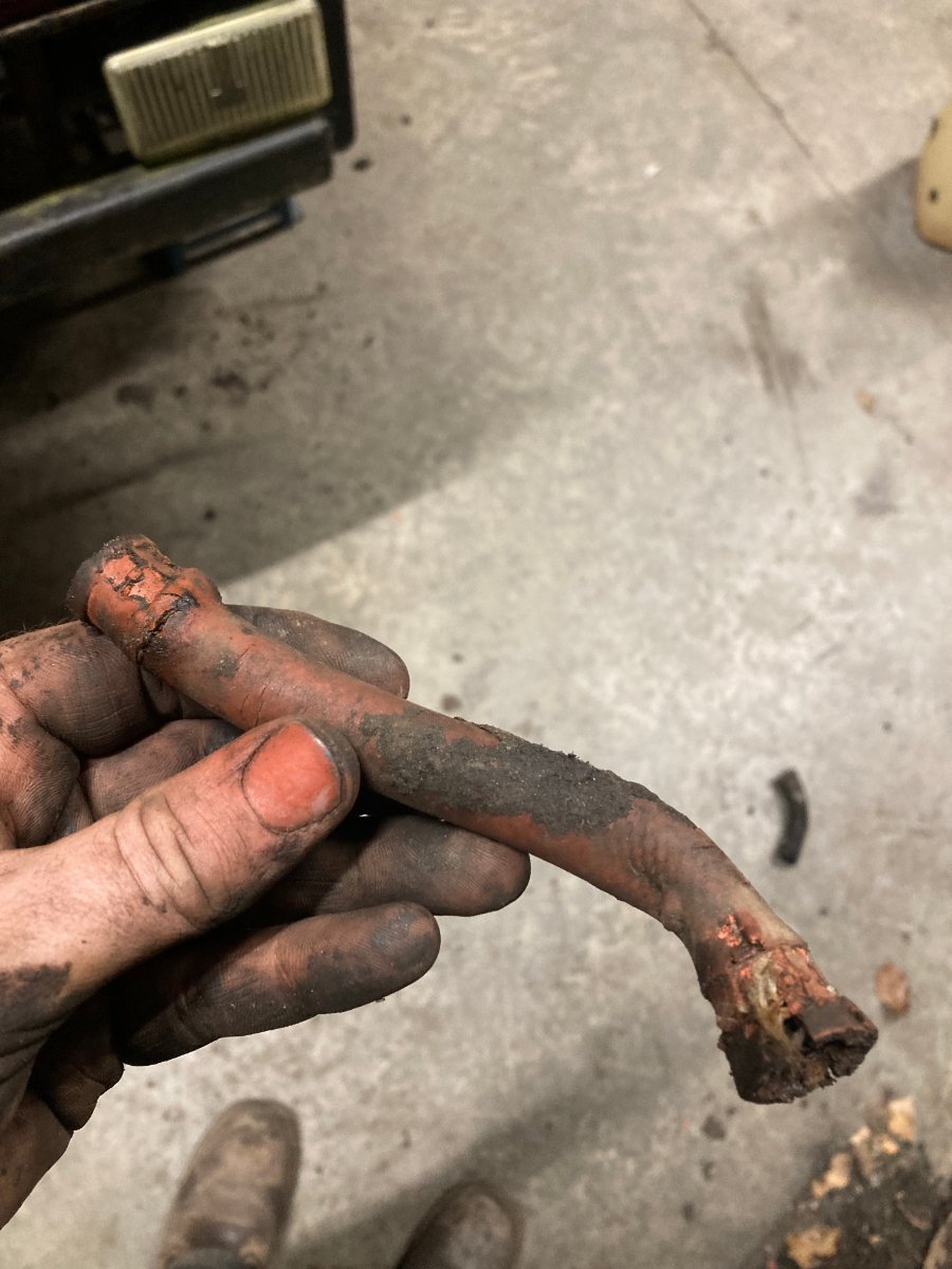

The first obstacle was figuring out which pipe was the fuel feed from the pump, because the absolute clusterf*** of pipes and hoses surrounding the throttle body and manifold, this must have had the EGR disconnected at some point because there's vacuum lines with bolts stuffed in them laying absolutely everywhere.
- A quick question for the gurus on here, does the G13BA have a mechanical pump in the side of the block as well as the electric one in the tank? I couldn't really make heads or tails of the mess of hoses.
The in-tank fuel pump ran as expected though and sounded good, and pulling the feed line off the throttle body and cycling the pump yielded some interesting results:
Yeah, I guess that'd probably cause the engine to not run.

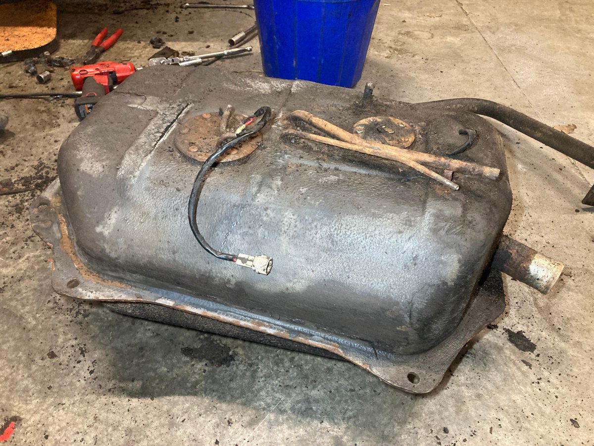

The next line of thought was that there's probably water getting into the fuel tank somehow, perhaps it's got a hole rusted in the top or a bad sender unit gasket, etc.
I decided to drop the tank and pour it out in any case, to see what was inside and to start fresh with good fuel. This thing must have been talking to my other Suzuki, an early SV650, as just a few days ago I had the same problem with water in the fuel.
Tipping the tank out into a 20l container yielded this (the leaves are external) :
That's a lot of water, but at least there's no evidence of rust or other detritus swimming about in it. The fuel tank itself seems to be in pretty good nick, a few bare rusty bits on top and on the seams, but not bad for 28 years old.
The bottom half is covered, along with the rest of the chassis, the running gear and the rest of the underside of the car, with some sort of sticky black underseal stuff (the mark of an honest motor as i'm sure you all know). We'll see what horrors it's hiding in the future I'm sure.
I hit the bare bits of the tank with a wire brush and some red oxide primer just to give it a fighting chance. Before it goes back in I think I'm gong to wash it out a few times with fresh fuel as there's definitely some liquid in there that I couldn't tip out of the filler neck.
While I think about it, the advert also said that the car had just had new fuel lines, among other things. I've not seen any evidence of that on my travels under the car, but there were a lot of sad perished looking looking rubber hoses, cut and joined and joined again, and a LOT of jubilee clips.
The fuel neck breather hose seems to have been replaced with what I can only assume is the kind of gas hose you find on a portable BBQ, which apparently doesn't play nice with unleaded:
I'm hoping to pick up some decent hose after work tomorrow if I get time and plumb the tank back in properly after a good rinse out and a quick blow over with some black paint, and we might see if it'll start and run properly. Maybe even drive, who knows. This is how it's sat at the moment, looking sad for itself but out of the rain and cold at least:

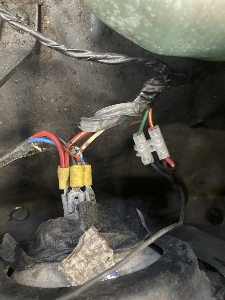

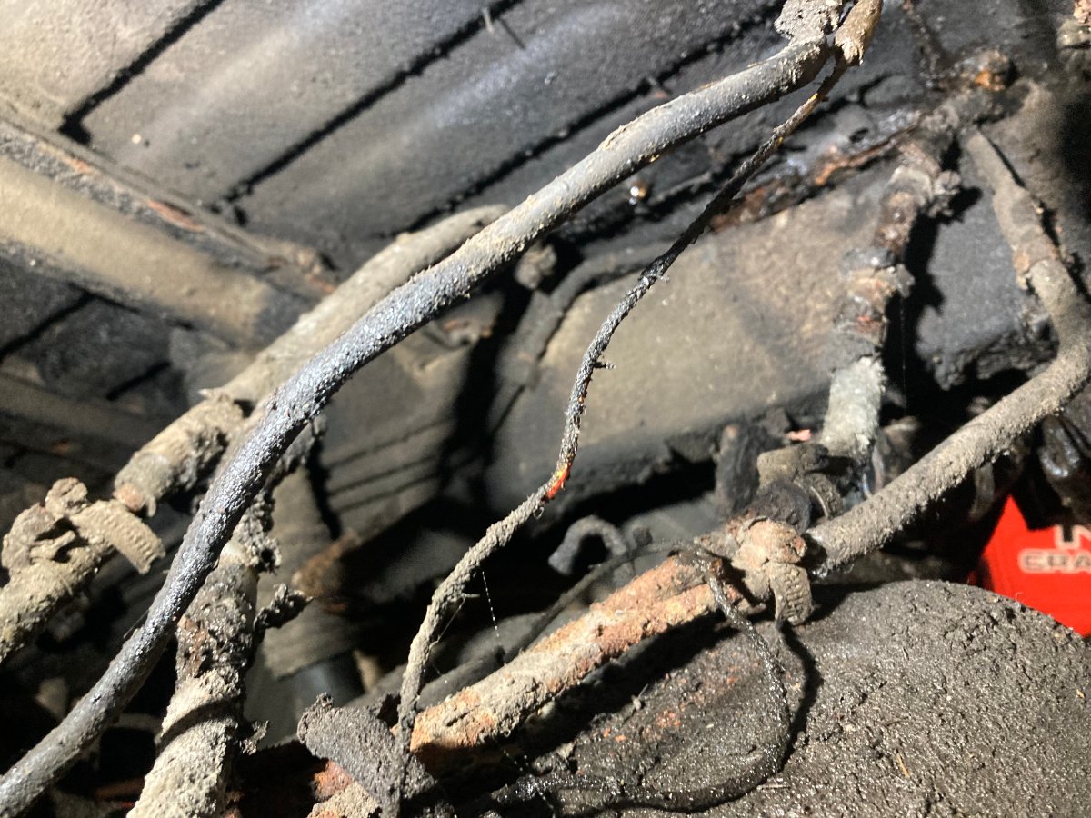

I'd like to leave you some photos of the wiring situation that I'll need to address in the very near future, to whet your appetites:
That's the isolator switch from what I assume is some sort of heavy equipment, the original key switch is destroyed and there's a smaller one bodged into the dashboard so that if you crash the keys become part of your knee cartilage. I'm going out on a limb here and guessing that there's some kind of substantial parasitic drain on the battery without that, despite the car only having about 8 wires in it.

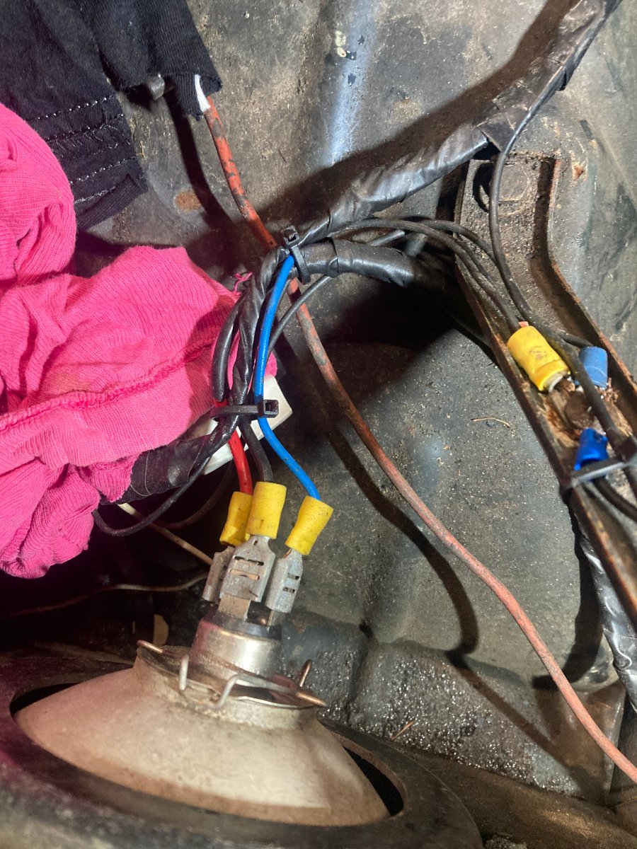

From under the bonnet, the headlights have been wired using large spade terminals for some reason and could very easily double as firestarters if those uninsulated terminals were to touch:
And some other random part of the loom that isn't wrapped up and is free to rub on the starter motor and the steering shaft, feat. electrical tape and badly crimped connectors.

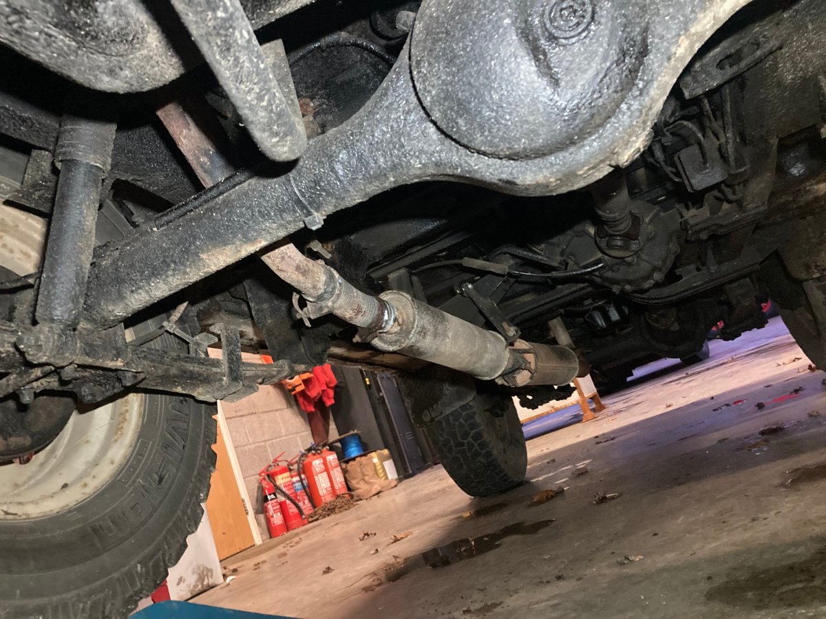

I'd also like to point out the exhaust system, which is made of random bits interlaced with flexible pipe, hanging off the chassis with strips of conveyor belt, and about 6 inches too low. The hump that's supposed to clear the rear axle is about 6 inches behind the rear axle as well. I think this might be a complete new exhaust job but we'll cross that bridge when we get to it.
I disocvered some other fairly horrific bodges which I'll share in the near future. The poor lass I bought this from seemed really genuine, I wonder if someone saw her coming when she bought it and ran off with her money. She did seem sad to see it go, though.
I'll catch you in the near future for more reasons why my mrs was probably right and I'm an idiot. ;)

😅 that’s a lot of water, no wonder she didn’t run.
Only the intank pump on the spi samurais. The mechanical pump on the head is only for models with carbs and they don’t have an intank pump.

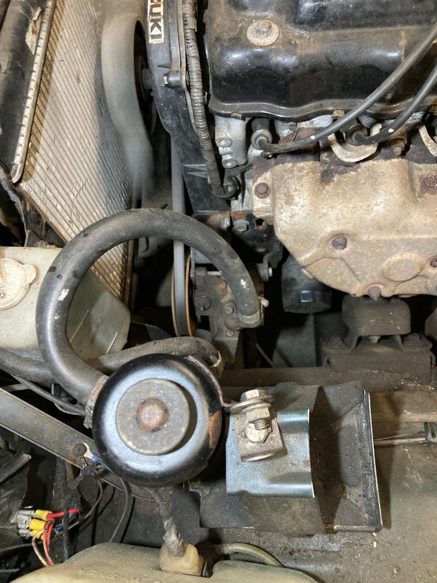

Anyway, we were poking around the engine bay while it was idling and I noticed that the power steering pump seems to be a bit... less than original?
Answers on a postcard if you know where that came from?

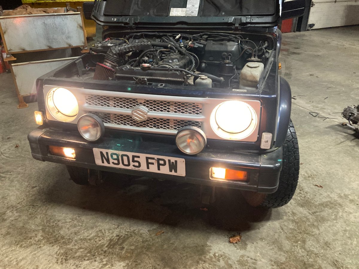

I turned on the lights to have a check and the poor engine almost stalled, god only knows what's going on with the electrics. At some point someone's decided that it needs extra LED lights for some reason, and I look forward to un-f**king that particular job in future :S
I know at some point I'm going to have to dive into the electrics...

So power steering wasn’t a factory option, looks like it might be a vitara pump and mount modified to fit with a different pulley. Chances are the steering box is either vitara with a wedge adapter or a Jimny box (Jimny box bolts straight on). Years ago people used to sometimes use Carlton boxes as well.

Making some good progress with this already. Was going to say same looks like a vitara pump. Looks like is been moved backwards to catch the factory pulley tho. Dunno if that's ideal for the rest of the pulleys tho? It's only ment to catch the crank, water pump and alternator? Could be issue with the power?
That's with a aftermarket pulley. Not sure if it would be to much load stretched round the ps to

There's tiger seal on the join between the header and the first bit of corrugated shite there. And at several other joins. It seems to be made up of about 15 different parts, none of which belong and all of which were welded together by Ray Charles.

@Rankine you're probably right about the auxiliary belt situation, as soon as you look at the throttle pedal the belt sings the song of it's people.
I'd like to return it to factory spec in that regard (and put the jack back where it should be) but shipping a new box from India will take some time. In the meantime, does anyone know any reason why I shouldn't just buy a proper OEM length belt and leave the pump out of the loop? Or even better, remove the pump and cap off the fittings on the steering box? :?:

That exhaust is a work of art🤣
I would recommend keeping and improving the PS set up, power steering is an essential mod on SJs in my opinion (as mentioned in my PM 😅)

I’d check for broken wires in the engine bay and whip the cluster out to clean the connections and check wires etc. the wiring is pretty simple.
Just old so the end of the wires often corrode and break just before the existing connector in the engine bay.

I started on saturday morning by pulling that badly fitted power steering pump off and sticking it in the nearest skip. I'll get a proper manual steering box eventually, but for now I've adapted some fittings and looped a pipe filled with ATF between them. The steering is a bit heavier on the move than you'd expect of a manual box, but I guess the ratios are different.
Fitting a proper length auxiliary belt has made the car much nicer to drive as it doesn't squeal and judder when you give it some throttle or turn the wheels.

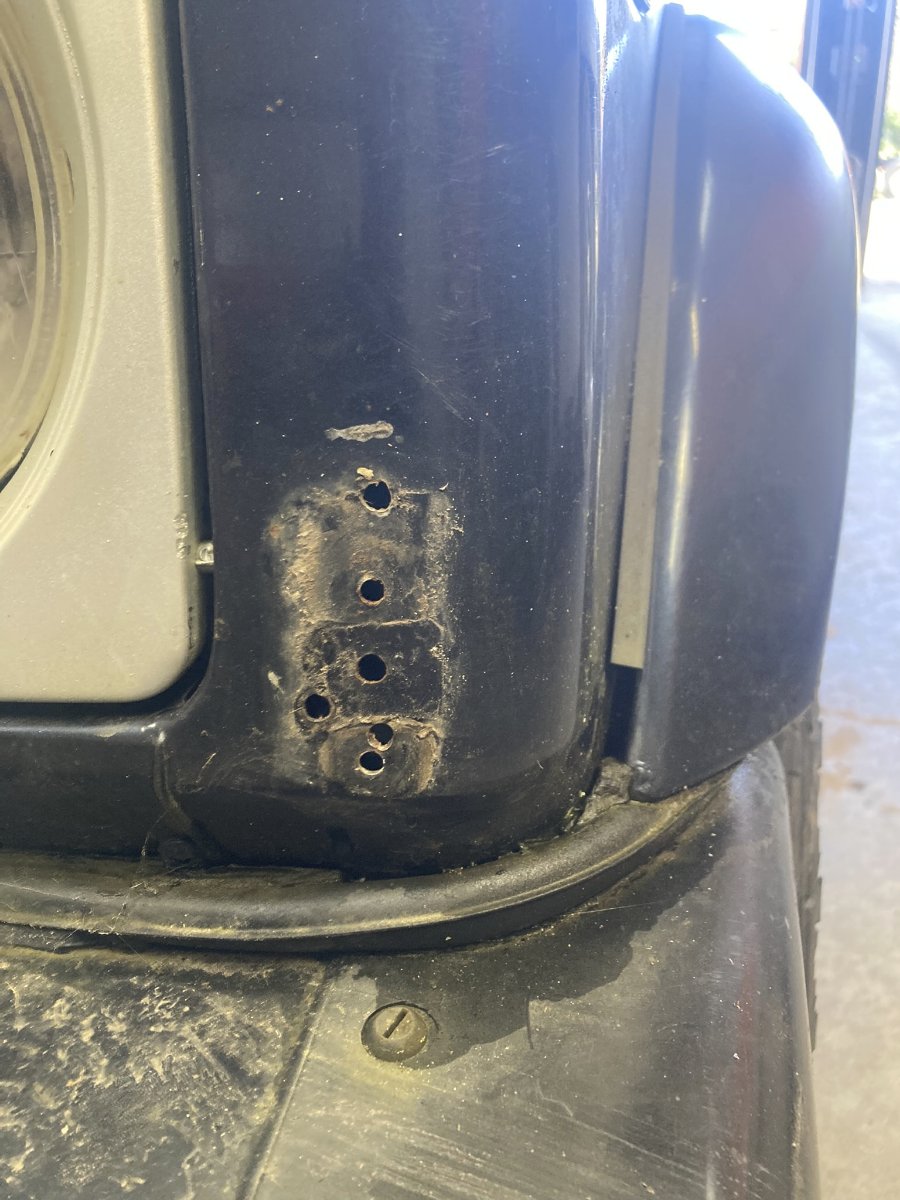

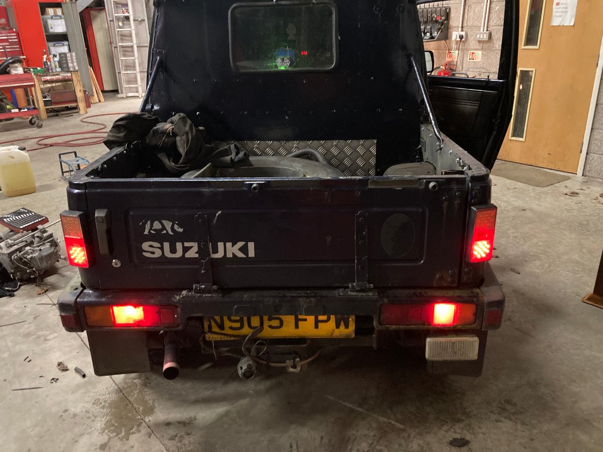

While I was poking about under there I decided to get shot of some of the redundant lights and wires that looked like the biggest fire hazards. Whoever added all this stuff to the car sure loved these screw-on terminal blocks.
I won't bore you with the details but I removed the driving spotlights that didn't work (and put them aside for later) and also the white marker lights from the front corners of the wings. I was expecting these to be LED but they were little incandescent bulbs of the kind you would usually find in an interior light.
Also, why drill three holes when 6 holes will do the job? :screwy:
The bodywork will have to wait until after the MOT, guess I'll be making little bits of sheet metal to go behind the holes and be plug welded in.

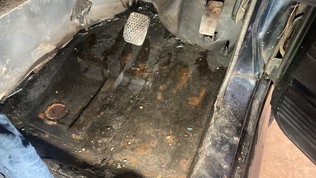

Pulling the carpets from the footwells required taking out about a hundred tek screws and the random lengths of aluminium angle that were holding it down. No idea what It's from, perhaps a jimny or something similar as it wasn't a million miles away from fitting. Underneath this was some thick insulation/underlay foam stuff that was marked with the VW logo in various places. Whatever it was, it was sopping wet and smelled terrible.
I didn't have any scales to hand but there must easily be ~15kg of wet stanky carpet and foam in that pile, which hitherto went into the bin.
I pulled the seats next, I don't know quite what they're from but a coworker suggested they look like a PSA design, perhaps a Berlingo van or something.
The driver's seat was professionally installed with some thin shelving angle stuff and tek roofing screws. They'd even left the washers with the butyl sealing ring on them, presumably to keep the rain out :er:
The passenger seat was far more custom, the craftsman must have gotten a MIG welder for christmas as the seat was held down with some bits of box section and some steel strips that were bolted through the thinnest section of floor. Perhaps he also did the exhaust.
The carpet under the seats was even wetter than in the footwells. It had been nailed down to a piece of wood that was attached to the bulkhead at the back of the cab.
No idea where the water could possibly have been getting in through... :er:
Both footwells and the floor behind the rear seats have sections that have obviously been replaced with sheet metal, and patches in various places, but there were no jagged rusty holes like I was expecting, so fairly happy with that. You can see the bits at the rear of the cab where they've plated over the rusty mess underneath where the body mounts are.
For some reason the footwells had been painted in what I can only describe as molasses, horrible brown sticky crap that needed thinners to get it off.

I found a bit of thick (8mm I think) aluminium plate in the scrap pile and fabricated this plate that bridges what's left of the seat mounting locations. The new seats have rails that are much further apart than the original seats, and the rails needed to be fixed much further back.
This is what I came up with after some trial-and-error fitting, you can see the four threaded holes for the seat runners. Those seats are a tight fit, there's only about 5mm of clearance between the side of the base and the cabin wall, and through this gap is where the seatbelt runs.
I don't know if this is what you would call a permanent fix, perhaps in future there might be some bucket seats or something, but for now it means i can actually comfortably drive the damn thing.

I'm pleased to report that as of this afternoon the oil is nice and clear, the coolant is staying where it should. A bit of a leak from one of my steering box fittings but I hadn't any PTFE tape to hand at the time.
This week I'm hoping to replace the exhaust, if it shows up, and get to work on fixing the electrics and the rusty bits under the back of the cab.
