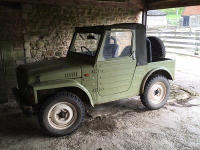

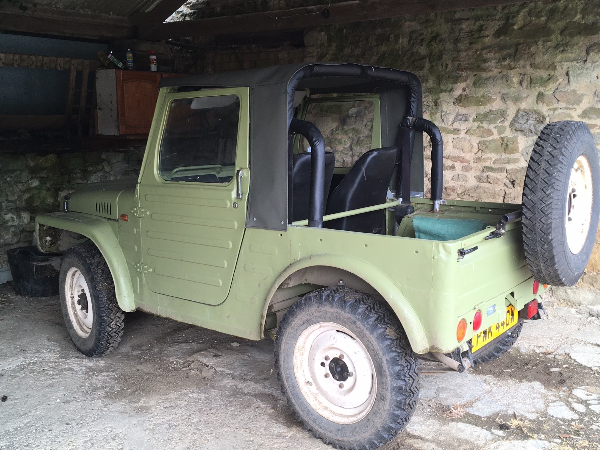

Post by lundigee » Sun May 16, 2021 3:28 pm
Well, either I have had corona virus or my sense of smell is haywire. The LJ80 went through the MOT with two advisories (i) slight play in steering box, now adjusted out and (ii) crack in the windscreen, but out of vision and wiper zone (character).
When it came to emissions max permissible CO was 4.5% the LJ came in at 0.13%. as for HC the max permissible is 1200 the LJ came in at 607PPM.
Couple of pictures just back from the MOT.
