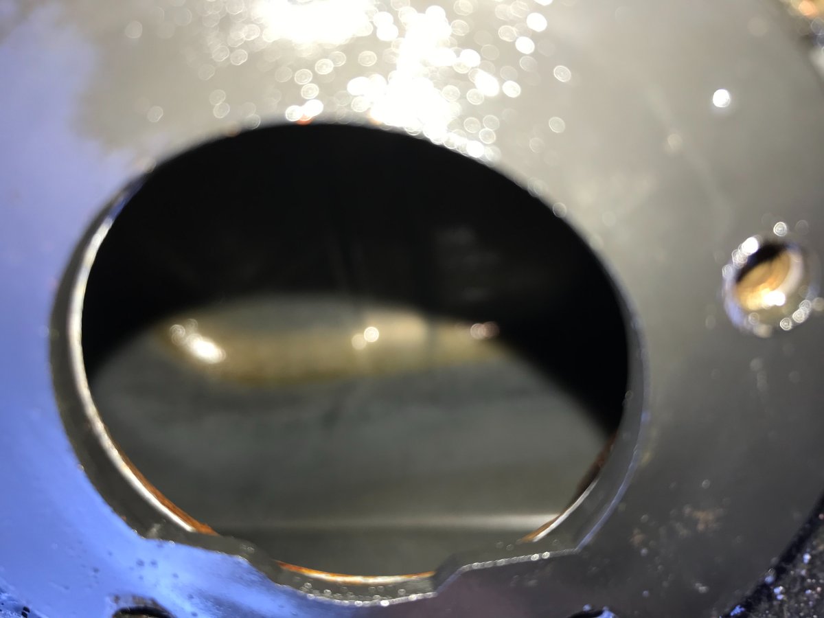

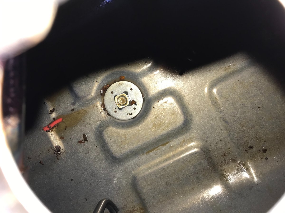

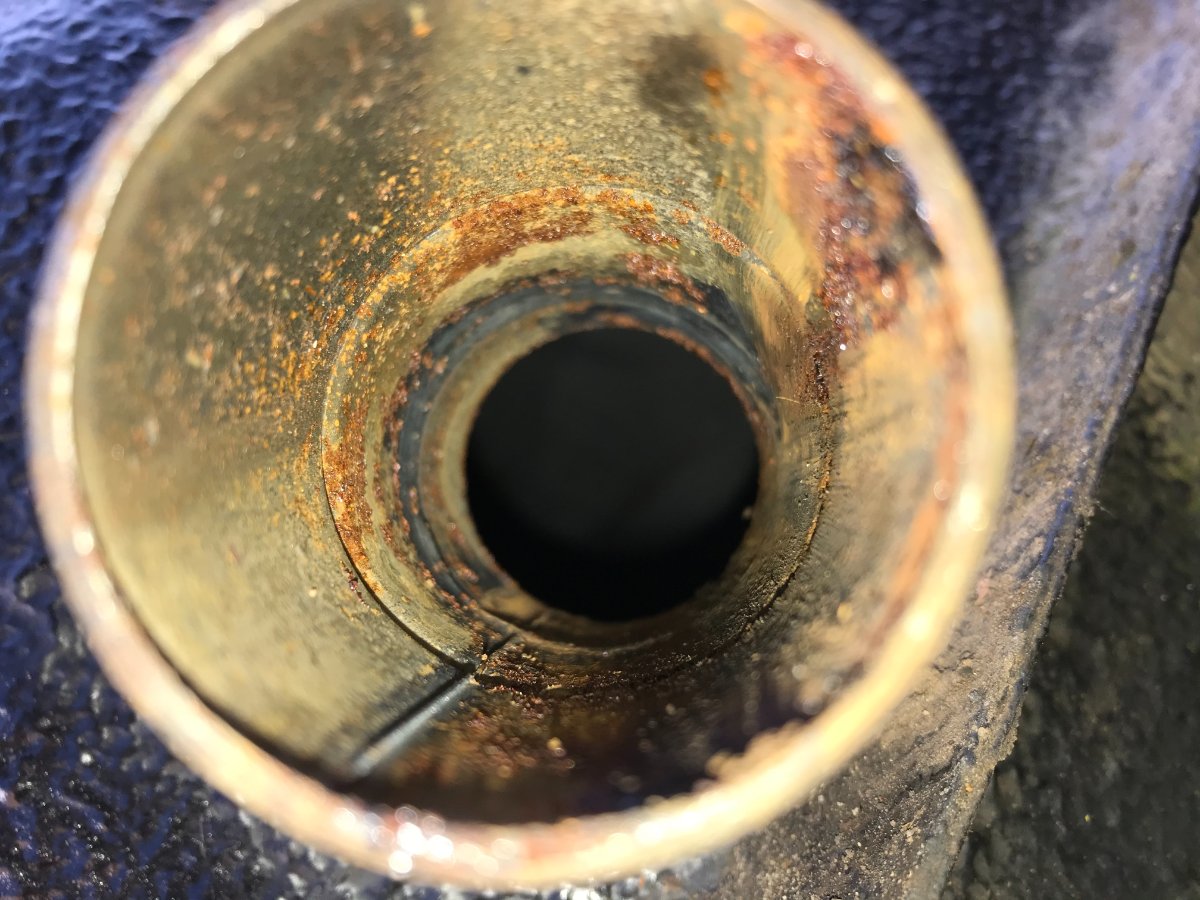

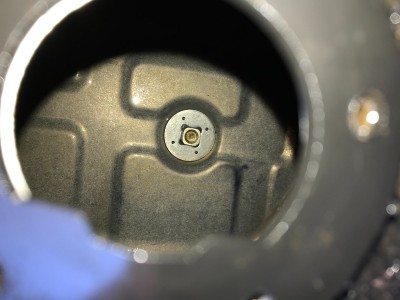

Been on all day, took tank off and it was not really as bad as I thought it would be by the amount of dirt it pulled through, in to 3 separate filters. first 2 pics before and next 2 after. Anyway done it the quick way, put some nuts and bolts in and shook the life out of it, untill nice clean petrol coming out.
Blew through lines again then fitted everything back together with some fresh clean petrol. Getting dark by now . Tried to fire up but just turning over no fuel getting to filter Yet. Battery not the best and died so charging it tonight Hoping e it fires up tomorrow.
