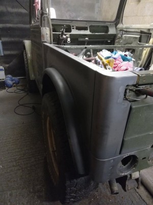

I'm still going on it. still plodding along with this dam metalwork... This is the bit I've been working on making nicer recently and I'm fairly happy with how it's looking.

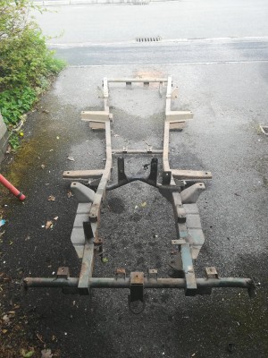

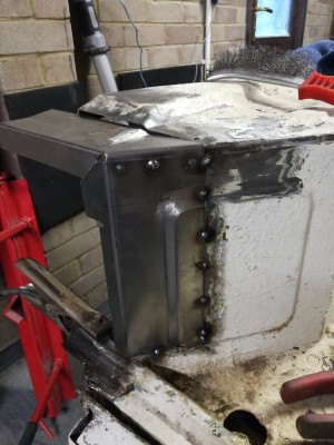

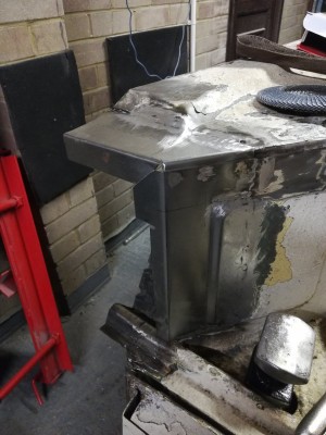

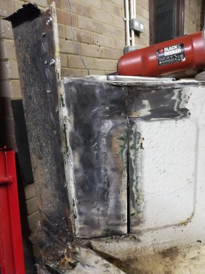

Quick update! I finished the welding on the tub, (for now).

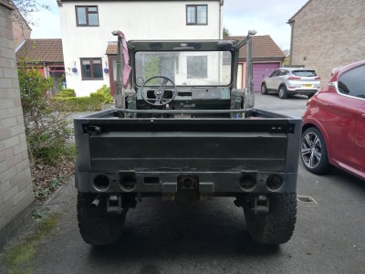

And now this is it's current state

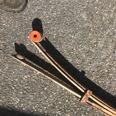

Also would anybody happen to know if the rubber suspension bushes are the same size on a sj410 as an lj80? Ones for an sj seem more readily available!

Re: LJ80 Recommissioning.
I’ve got SJ bushes on mine
Excellent! That's what I'll get then. Thanks very much
