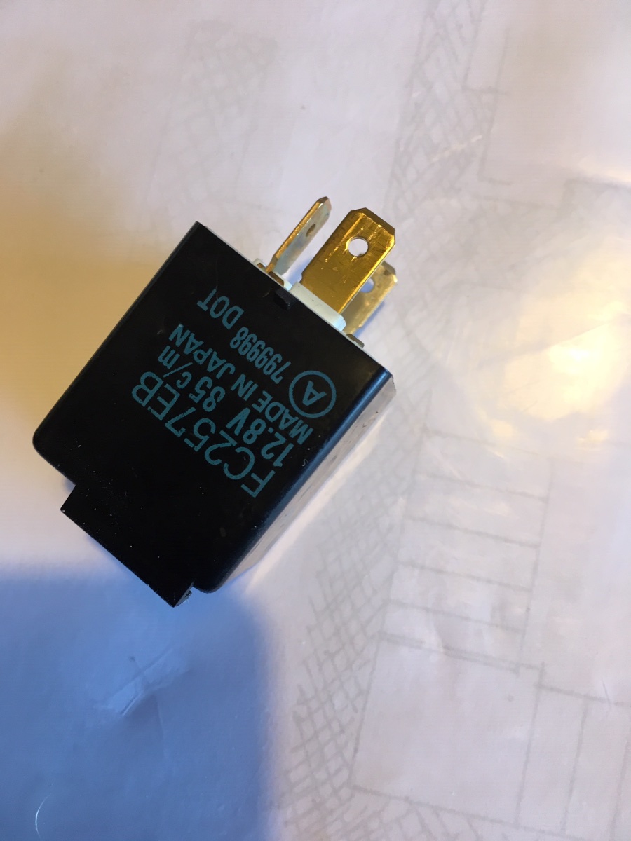

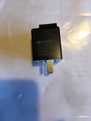

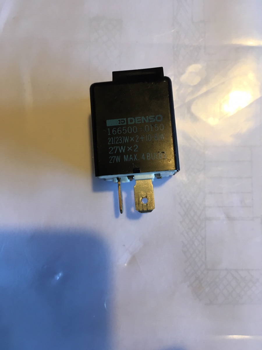

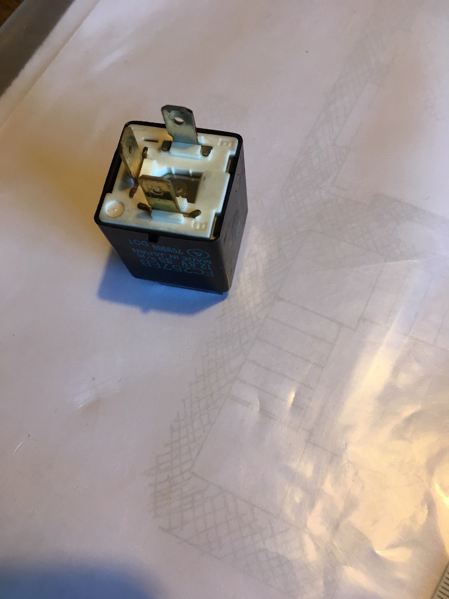

I pulled this out late yesterday, sits just above the regulator.
Let me know if it looks the part, if so private message your address and I will pop it in the post.

That's great mate Will send you my address let me know how Much, Thanks Very Much

Thanks Mate, Its Jap, managed to borrow a relay as Lundigee has kindly offered to send me one. plugged it in and they worked straight away, I so pleased about that.
