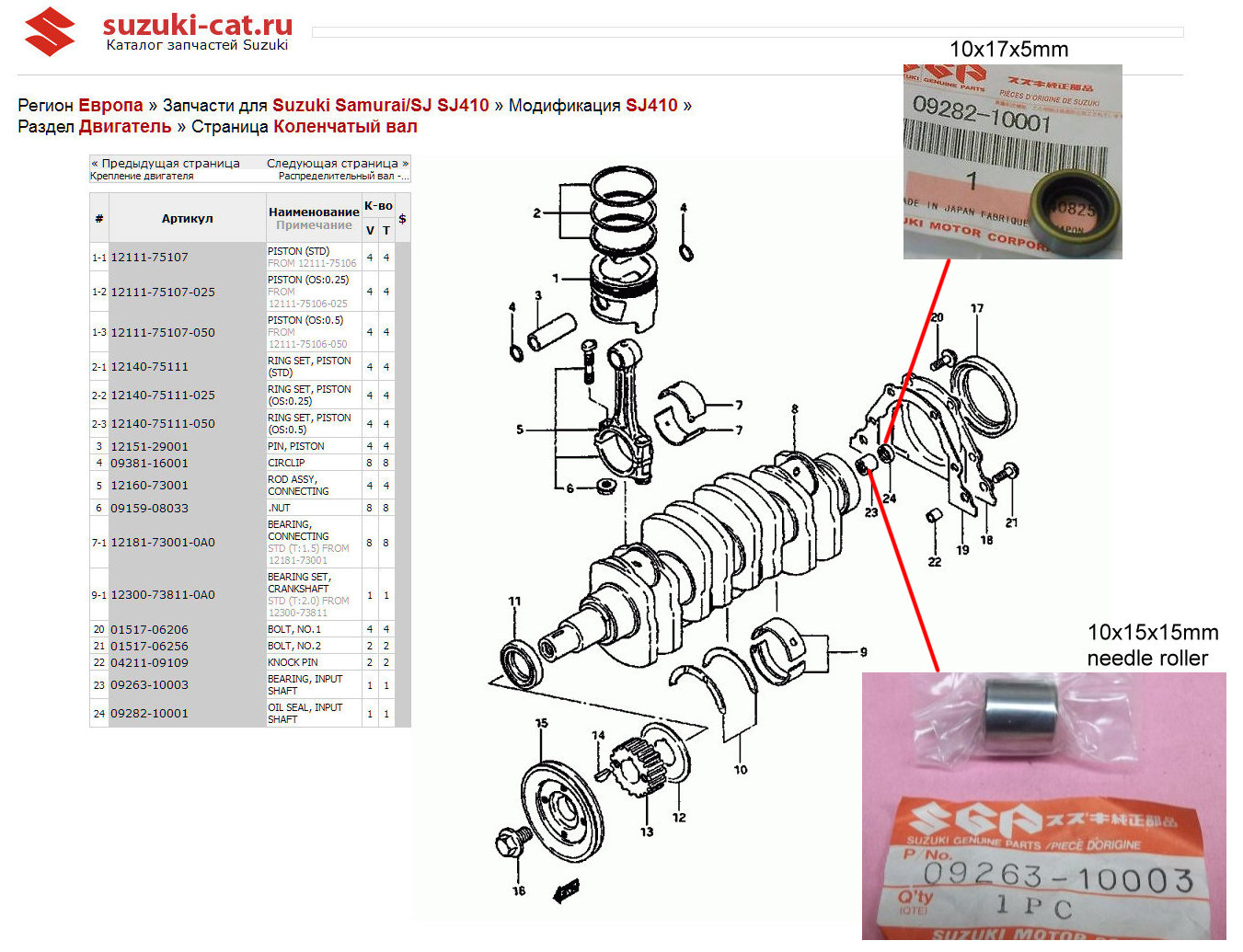

Hello, About to rebuild a F10 engine which has the spigot bearing in the crankshaft, not in the flywheel like the later engine do. Anybody know what size they are or where they can be purchased from. Any ideas ?

I've put this together...
SJ410 crankshaft spigot bearing.jpg (313.06 KiB) Viewed 7459 times

Darrell wrote:I've put this together...
Thanks Darrell, your always there to throw up a quality parts diagram, we probably don't appreciate you as much as we should!

Thanks Darrell, I had measured the crank hole and input shaft and was looking for a 10x 15x 15mm needle roller but nobody seemed to list that size. I then presumed i had measured something wrong. Looking at your pictures, did you go direct to a Suzuki parts dealer ?

The diagram is just a page saved from here https://translate.google.co.uk/translat ... egion%3DAR with a couple of photos and info added after I "Googled" the part numbers.

Used your picture Darrell and searched Google again. Found the right size from a UK company for a fair price and they will post to Cyprus. Thanks for your help.
