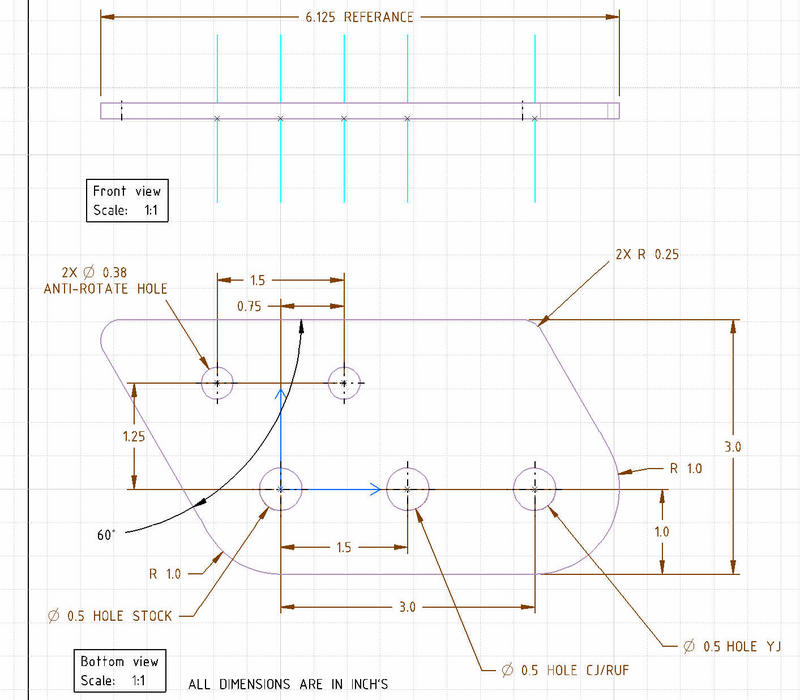

Re: Some ruf questions.
410/413/samurai springs should all be the same length, but possibly different leaf counts
There are adapter brackets which combined with different shackles should keep the axle in the same place.
As its only 2" ish lift you probably wont need a propshaft spacer
You could use missing link on the back but it can give undesirable handling, more so on the front.
Tbh Ive got +2" springs on the front and massive regular shackles on the back, handling is OK and suprisingly gives pretty good flex.
Been running it like that for years now, and while its not a good option, you could do it cheaply until finding some 2" lift rear springs to match
Thank you for your answer.
Thank you for the plan too!
I suppose that i have to use the "cj hole". Right?
"You could use missing link on the back but it can give undesirable handling, more so on the front."
What do you mean?
What do you mean?
