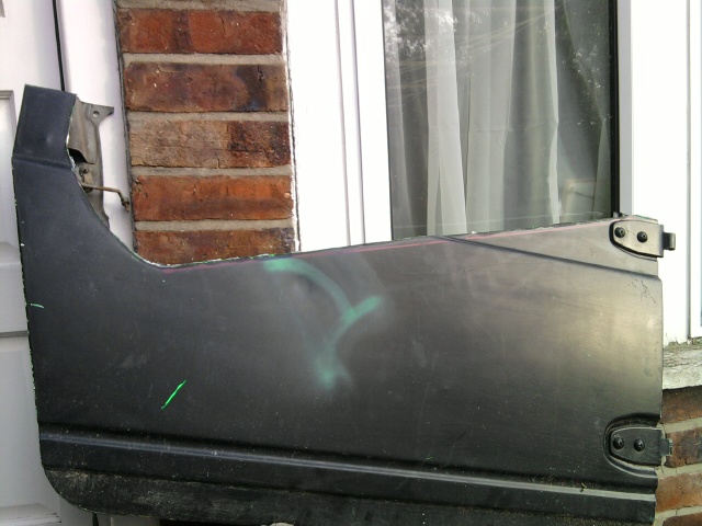

Post by ScottieJ » Sat Jun 26, 2010 7:05 pm
It's bloomin hot today so I finished my half doors, The quick way 8-)

lovin them doors scottie...........but carnt belieeeeeeeve you aint got that cage on yet(sorry.....just call me mr impatiant :lol: )

Yeah I know! i've been crap! still need to go pick up the rest of the tube work, then i might get it fitted :lol:
would quite like to try and get it done this month before i go to france but we'll see!

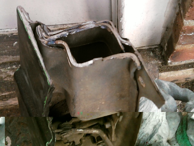

scottie what did you do about all the metal bracketry at the latch end?
this lot
this lot
cheers 8-)

scroll across a bit more :lol: :lol:
It looks like i've cut mine down more than you as i've even cut some of the top of the latch mechanism off and still use it to hold the doors shut.
Push here and the door opens :mrgreen:

Post by ROBBIE » Tue Jun 29, 2010 1:31 pm
ive gone for a difrent look
think ill cut that as low as yours though mate cheers 8-)

Scott, how much where you able to cut of the latch?
With the ones im making, ive cut along the same line on the door, but have about 2-3mm of latch sticking up?

Post by ScottieJ » Fri Jul 16, 2010 12:07 pm
you can cut quite a lot out of the catch, i'm going to whip mine back out this weekend and work out exactly how much of it I can completly remove.
As a guide line though you can easily cut it down to this line

Post by Henry » Fri Jul 16, 2010 2:35 pm
Cheeers for that, i can have a nice flat top on the half doors now then.
