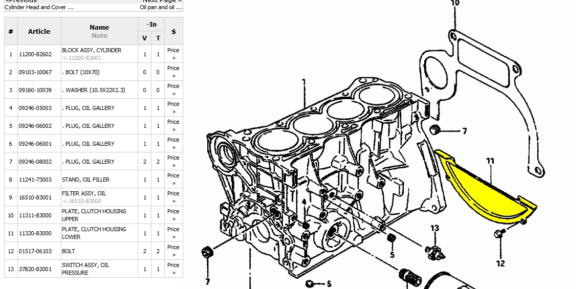

Was fitting the gearbox to my 413 engine the other day and noticed that there is a gap at the bottom of the gearbox where it meets the engine block. Its only about an inch gap but leave the fly wheel and clutch open to the elements. Is there some sort of plate/gasket that goes between the two? My apologies if this is a silly question.

Crud guard. A semi circle piece of plate. See if i have a one lying about
Also need the plate for the top which i forgot to give you.

Awesome cheers man. Sent mike harris a text about the various bits i was missing, so fingers crossed he can help out with a few bits. Also got oil filter and exhaust manifold gasket ordered. Cant wait to get this underway!
Re: Gap between gearbox and engine block
- plate.png (119.37 KiB) Viewed 4964 times

good chance im missing part 10 as well......any one got a part 10 kicking about?!?

if you was about 2 months faster i had one you could of had but now chucked it away

I have part 10, forgot to give it to you. Got 3 or four of them.
