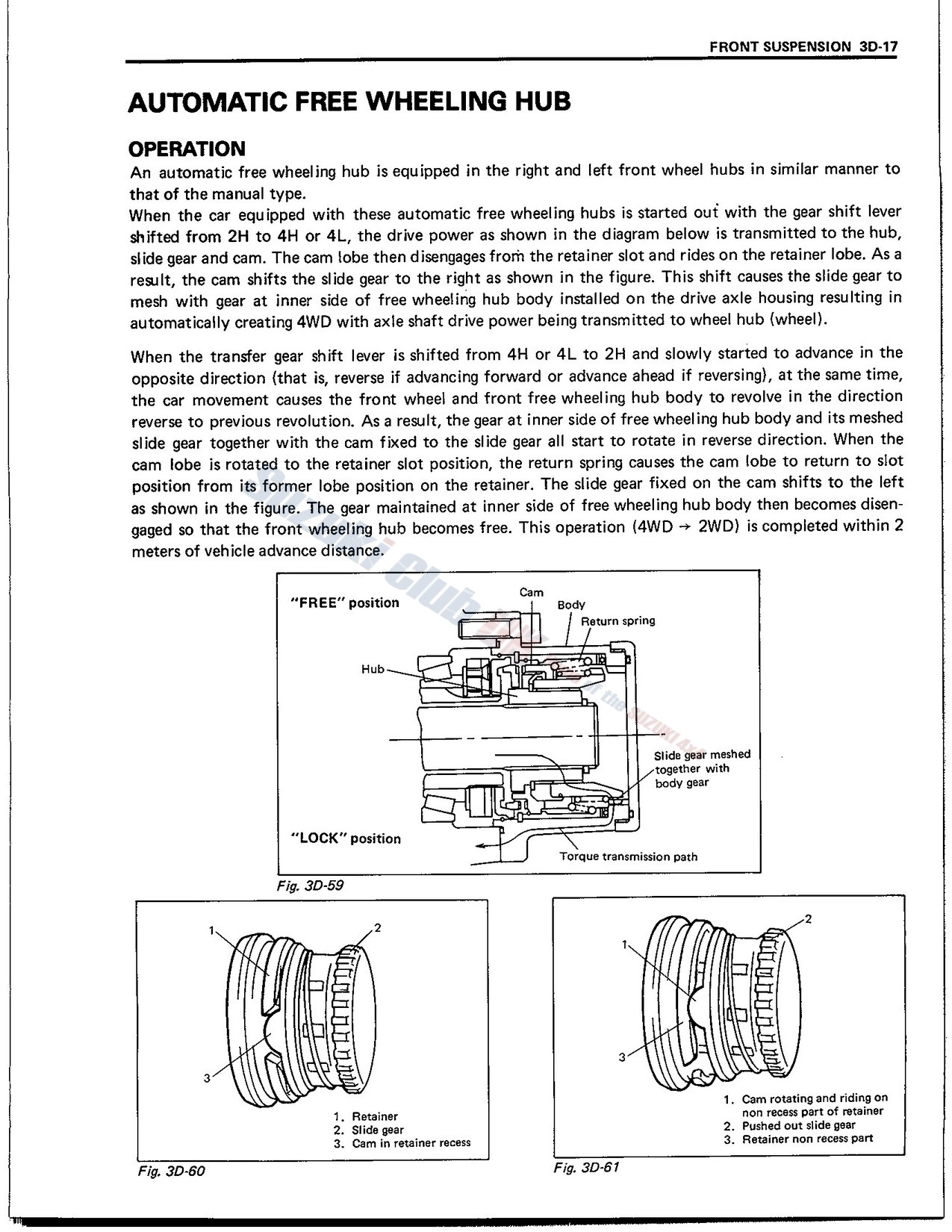

Hey guys.
How can I test if auto free wheeling hubs are working?

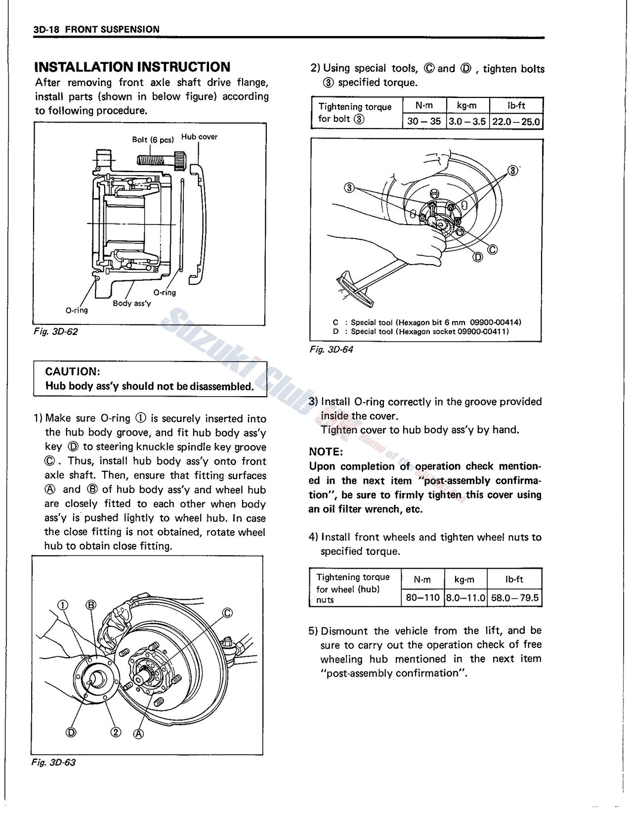

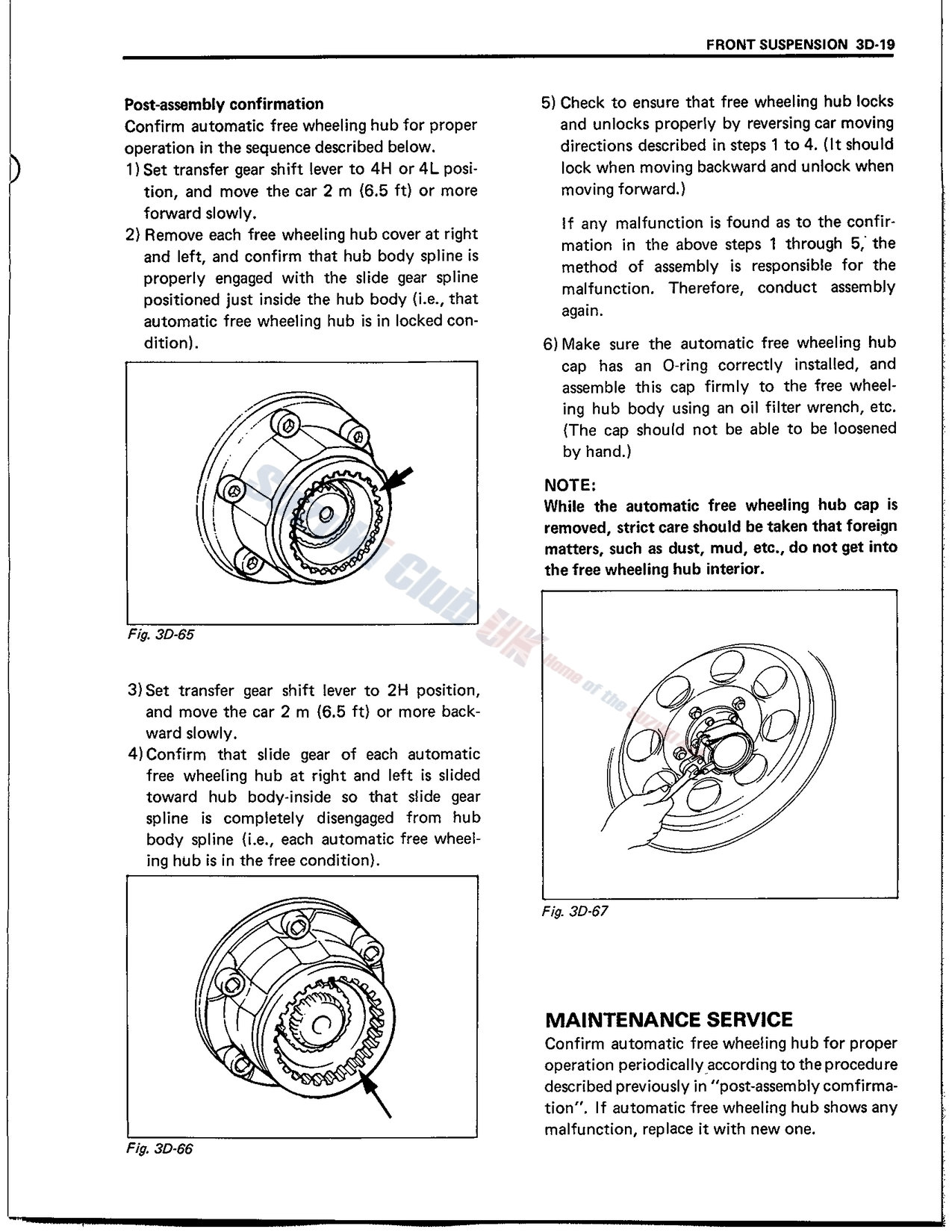

Post by Darrell » Sun May 12, 2013 10:01 am
:S
Auto hub 3.jpg (405.6 KiB) Viewed 3336 times
Auto hub 2.jpg (365.58 KiB) Viewed 3336 times
Auto hub 1.jpg (408.27 KiB) Viewed 3336 times
