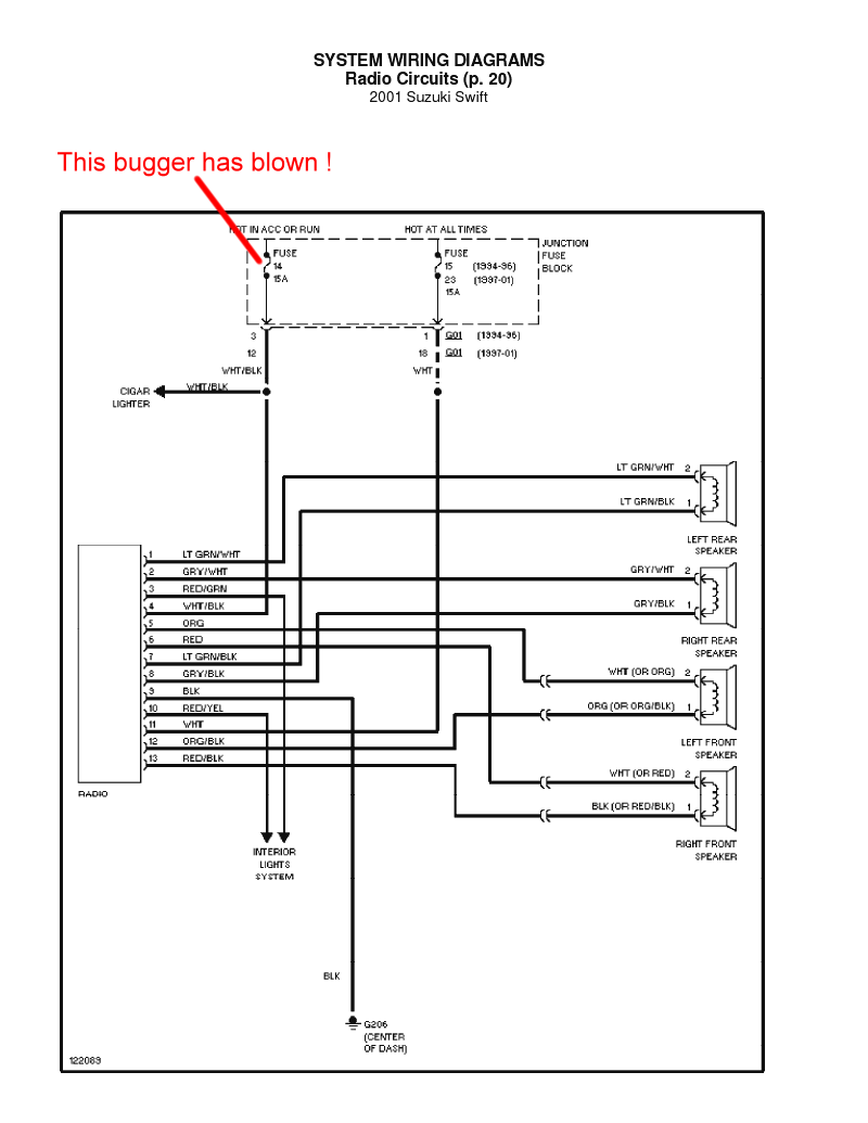

Re: 2000 Suzuki Swift Radio
Found a circuit diagram and it shows 2 fuses , having another look online they are up under the dash somewhere.
- fuse.png (49.73 KiB) Viewed 9569 times
Great thats it!!!!! thank you very much ill sort that out in the morning!!
