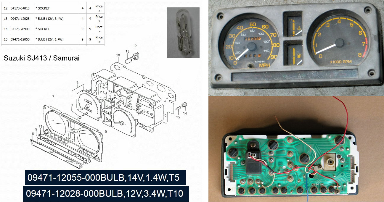

Anyone know what type they are?
Blown in top right corner which lights up upper part of rev range.
Re: Dash bulbs
Post by Darrell » Thu Feb 07, 2013 10:52 pm
Not sure what dash you have ??
So I've done this for mine , hopefully yours is the same :thumbup:
Suzuki sj 413 clocks.jpg (204.04 KiB) Viewed 3643 times

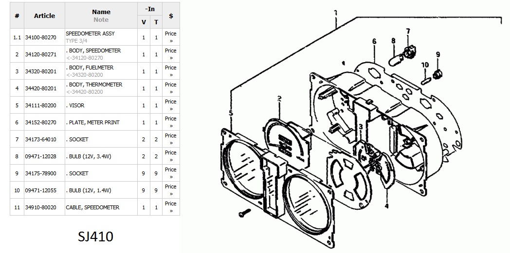

Re: Dash bulbs
Post by Darrell » Thu Feb 07, 2013 11:07 pm
Same numbers :thumbup:
