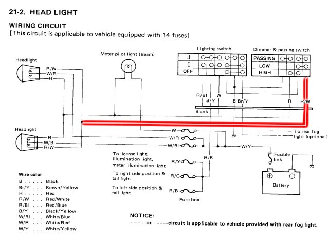

The haynes manual for the SJ wiring is useless. Here is the circuit diagram for the Japanese built models (switched earth).
It sounds like the r/w wire is open circuit or the high/low switch is playing up.
I think I understood your request but have reworded it as I was not sure (sorry).
If yours is Spanish built it could well be switched live and therefore a different diagram.

Hi. Thanks for all the info, i think mine is Japanese made as its switched earth. I will trace the wires again tomorrow.
