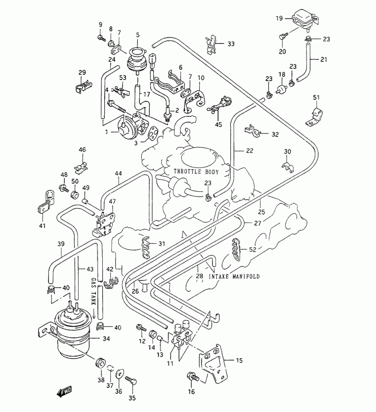

Um.. Unfortunatly the black canister on the right side (off side in uk) of the engine which obviously takes a rubber hose has no hose fitted on my 99 santana vit 3 door soft top jx. The engine is a 1.6 8v.
Some similar models have two hoses fitted in the top but mine only has one pipe .. Does anyone have a pic of the single hole model and where os the pther end attached... Could this be the reason for a fast idle 2k revs aprox.

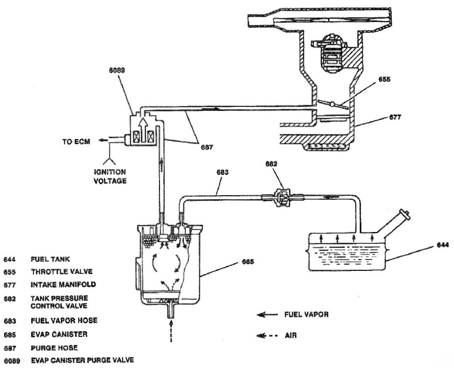

Errrr.. Just discovered it has been inverted .. That is why there is one hole.. How stipid can one get and still get a licence to drive!! Now the question is should I turn it right way up? It is the charcoal canister which takes the fumes from the tank I think.. What goes on the bottom single pipe..
Nick
Re: What is the canister at front rt of engine
Post by Darrell » Thu Aug 23, 2012 9:11 pm
I can't find any diagrams showing a hose connected to the bottom pipe. It's shown as an air intake so I assume it has no hose. I assume the small amount of air intake is filtered by the canister :er:

Job done guys.. Thanks again.. Bottom of cannister is now open to air and pointing to ground.. CEL is code 12 all systems good.
