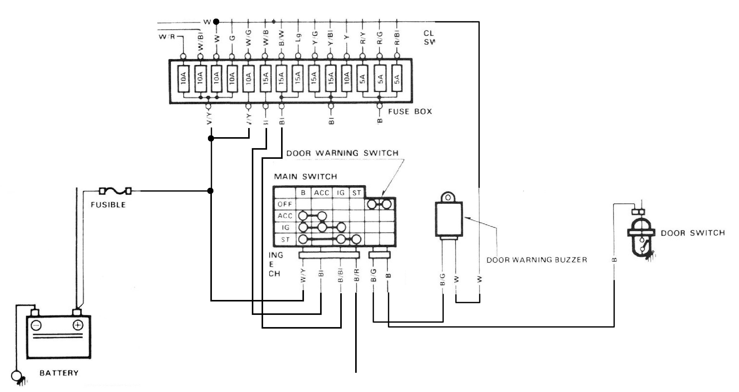

Well I must admit I've been through all that circuit diagram and cannot find out why it doesn't run with the ecm disconnected. I also cannot understand why the key buzzer doesn't work with it disconnected either
as it does not link to the ecm at all. You say everything it dead with the ecm disconnected
, it's almost like somebody has fitted a relay between the battery and the main circuit (energised by wire from the ecm) but why would anyone do that
When you plug the ecm in, do you hear a click from anywhere (clutching at straws here

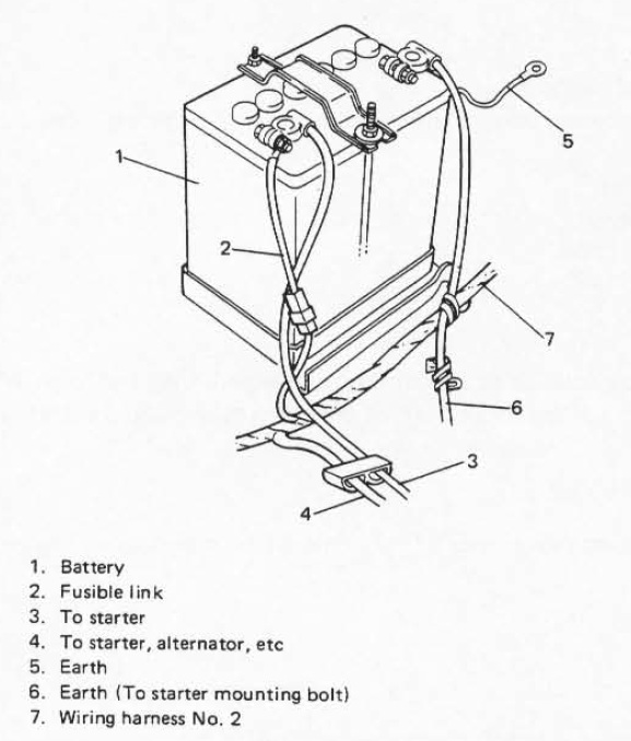

Just incase anyone was interested in the results of the problem. There seems to be an overwhelming agreement that the ECM is taking the place of a bad ground.
Have never been happy with the grounds that are scattered all over the Rig and had planned on doing something about this situation anyway. Just seems like these grounds are put where ever they decided to without much thought. I will probably soldier all the back grounds together to a larger gauge wire and have them all located in one spot on the rear of the frame. Follow the same steps in the front and add a couple of motor ground straps to the frame and body.
Re: Trying to get rid of ECM
Yes they could be correct. If the link wire number 5 is not connected to the body it could be possible that the cab has no earth and therefore no negative for the coil and most of the other circuits. It must have a good earth cable to the engine as it starts with the ecm connected. The ecm does show 2 earths one being the engine.
Does it still turn over with the ecm disconnected ?
Like you said a good cable from negative to body earth hopefully will sort it.
You could always just use a jump lead to try it.
If the ecm is providing the earth it won't have adequate diameter cables to handle the current when too many things are on IE: heater etc and may overheat.
Sorry for going on, I just need to understand how things work
(or not as the case may be)
