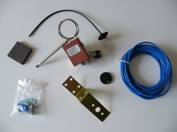

Post by turbo-tom » Tue May 01, 2012 5:19 pm
if iwas to buy the one below , would it matter is i was to cut it into the top or bottom rad hose? , as the tiop hose has my guage sender in :S
just had a thought that it would have to in the top hose wont it ?
Click Here for Ebay Listing
Re: electric fans
Post by Darrell » Tue May 01, 2012 7:19 pm
Yep :thumbup:
