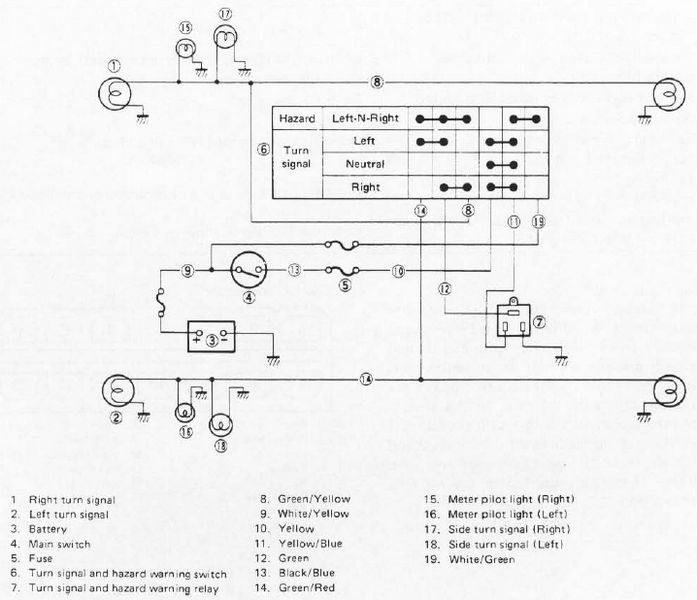

At this point the window wipers/heater fan etc work but the indicators/hazard lights don't The indicator and hazard circuits have different supply feeds so I'm going with knackered relay as you filled it with water :D

Or no earth on relay
Was the rear of the fuse board ok :IE not corroded.
indicator circuit.jpg (51.42 KiB) Viewed 9185 times

Still no indicators or hazards, i did replace the relay previously Darrell, it was full of water and rusted like you said but didn't make any difference.
