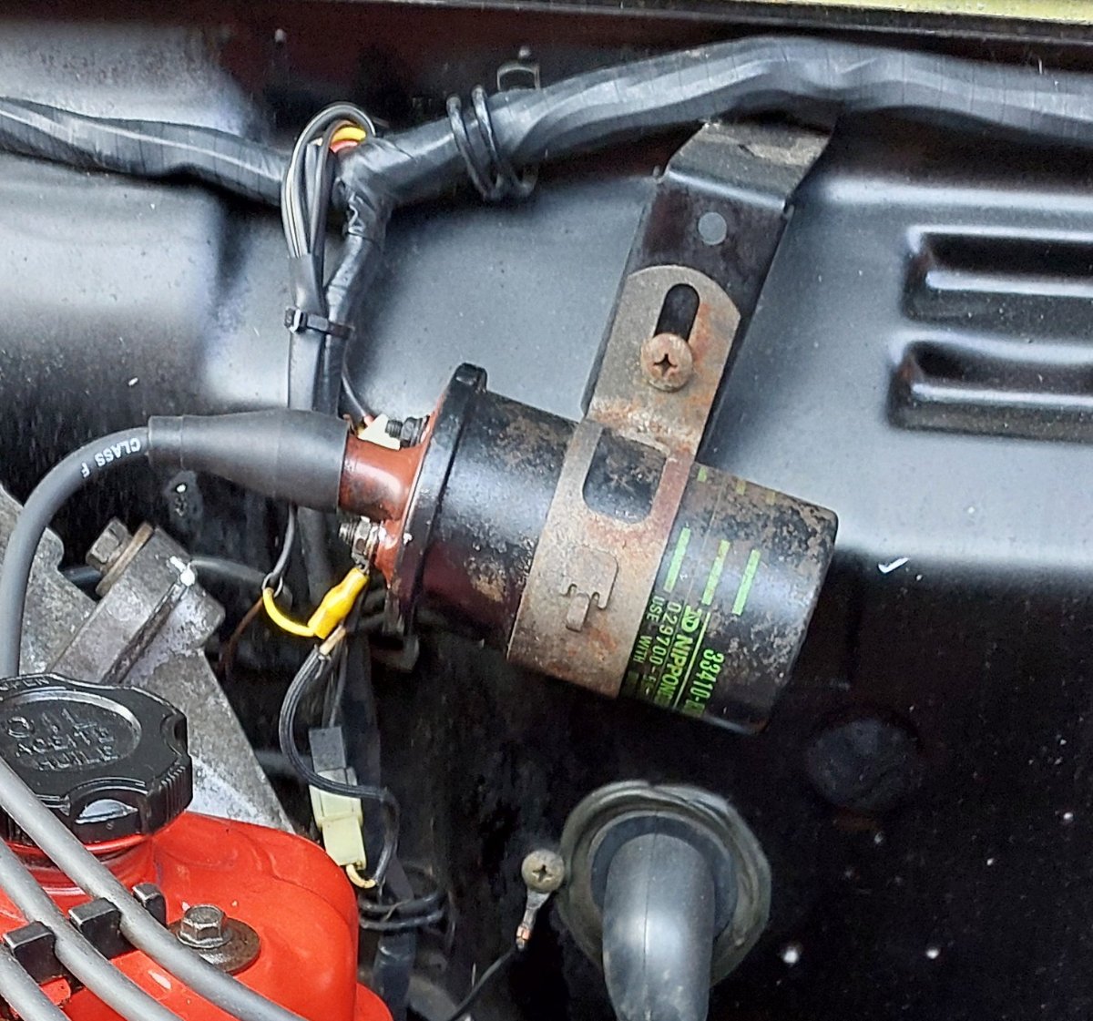

I am looking to replace the coil on my 1991 Santana Samurai. [G13A engine]
It appears no ballast resistor is fitted.
Is this correct for this engine?

Yes that’s correct.
Only F series engines with a points and condenser distributor have a ballast resistor.
