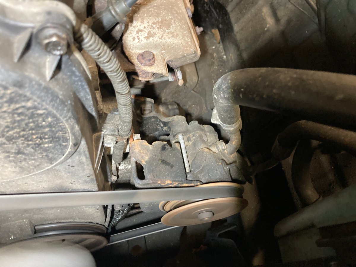

- A quick question for the gurus on here, does the G13BA have a mechanical pump in the side of the block as well as the electric one in the tank? I couldn't really make heads or tails of the mess of hoses.
The in-tank fuel pump ran as expected though and sounded good, and pulling the feed line off the throttle body and cycling the pump yielded some interesting results:

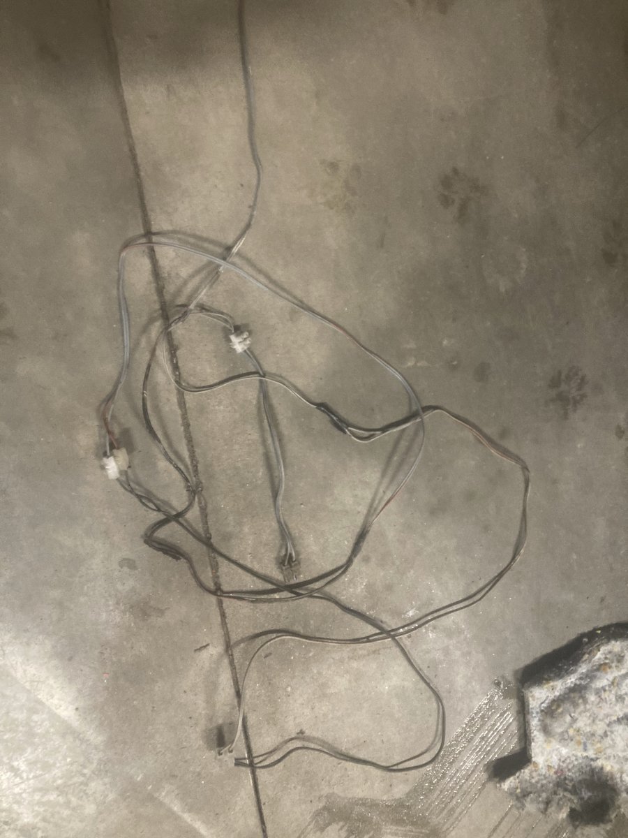

I'd like to leave you some photos of the wiring situation that I'll need to address in the very near future, to whet your appetites:
That's the isolator switch from what I assume is some sort of heavy equipment, the original key switch is destroyed and there's a smaller one bodged into the dashboard so that if you crash the keys become part of your knee cartilage. I'm going out on a limb here and guessing that there's some kind of substantial parasitic drain on the battery without that, despite the car only having about 8 wires in it.
From under the bonnet, the headlights have been wired using large spade terminals for some reason and could very easily double as firestarters if those uninsulated terminals were to touch:
And some other random part of the loom that isn't wrapped up and is free to rub on the starter motor and the steering shaft, feat. electrical tape and badly crimped connectors.
I'd also like to point out the exhaust system, which is made of random bits interlaced with flexible pipe, hanging off the chassis with strips of conveyor belt, and about 6 inches too low. The hump that's supposed to clear the rear axle is about 6 inches behind the rear axle as well. I think this might be a complete new exhaust job but we'll cross that bridge when we get to it.
I disocvered some other fairly horrific bodges which I'll share in the near future. The poor lass I bought this from seemed really genuine, I wonder if someone saw her coming when she bought it and ran off with her money. She did seem sad to see it go, though.
