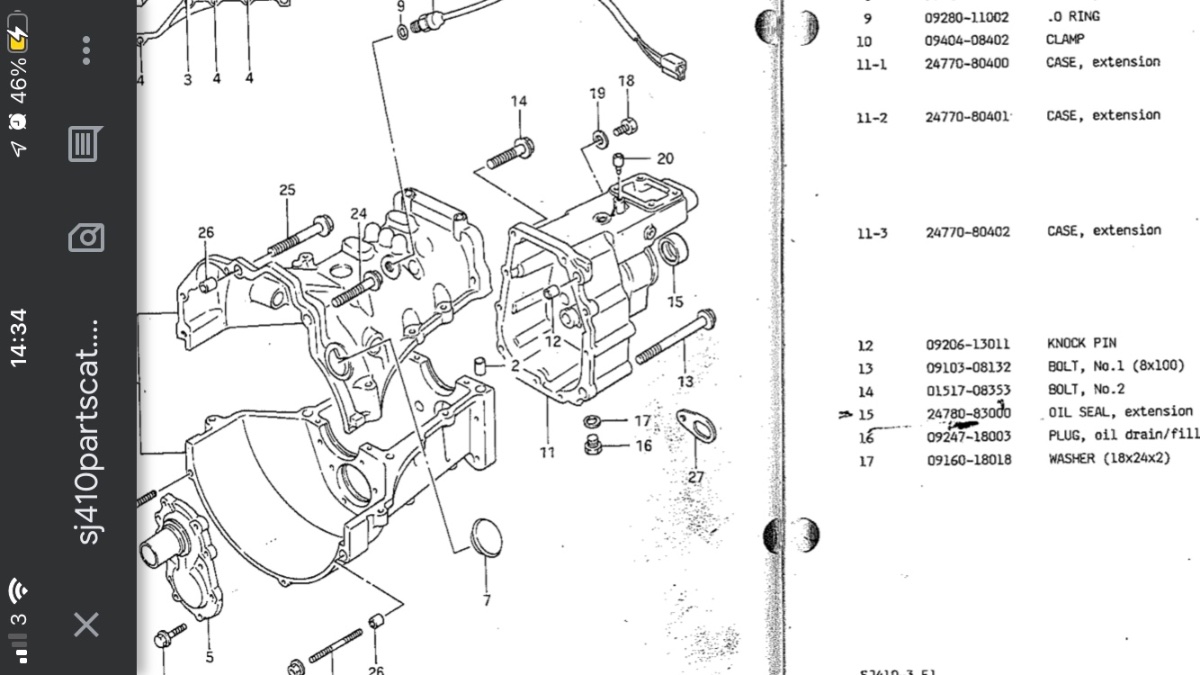

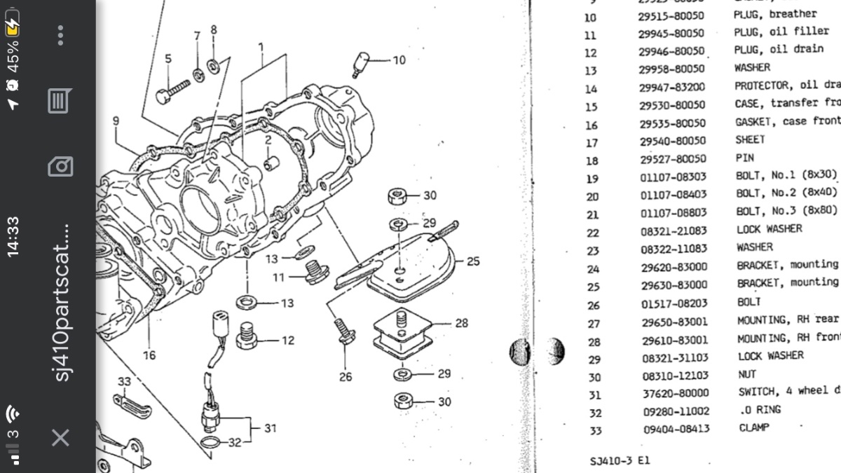

I might have stated the wrong with size (don’t believe everything you find on the internet) anyway but yeah ptfe tape will work. The tapered style plugs without a flange have ptfe on to seal.
Part numbers here
