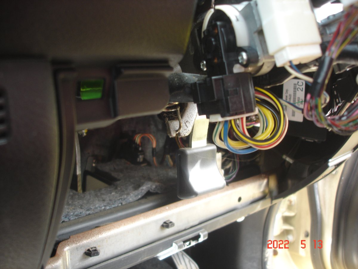

by suzukitomcat
Picture of Ignition Switch connection in & out.
