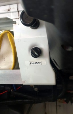

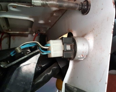

Yes, the heater resistor will be in the air flow inside the heater box. It needs to be there in the air flow as the resistor wires get very hot. The photos show all there is behind the switch is the connector to the fan unit. The plastic dash was removed about 20 years ago and trays made in the empty space to vastly increase storage area.

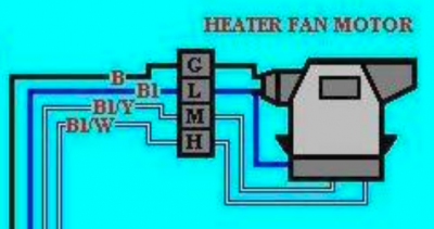

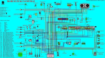

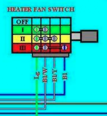

Attached is a wiring diagram detail of the heater switch and fan connections I think I got from this site for a 86-88 Samurai - the drawing was by Corey Daniels. Lg is light green - goes to a 15A fuse. You could try briefly putting 12v positive directly onto the positive fan terminal. The negative one is connected to the body. This would test if the fan motor itself is OK.

Thanks again Kiwi - progress by accident here. Yes, resistor must be in heater box, all that's behind dash switch is the actual 4 setting switch.
Getting to the connector and the actual fan is a right sod. Decided to re-test switch- a few wiggles in case contacts dirty. Now I have low and mid speed without really doing anything. I'll live with that happily. The absolute ideal would be swap out the heater box with one that is really cleaned out, resistor, hoses etc checked. But that's a dash out surely and I do not fancy.
