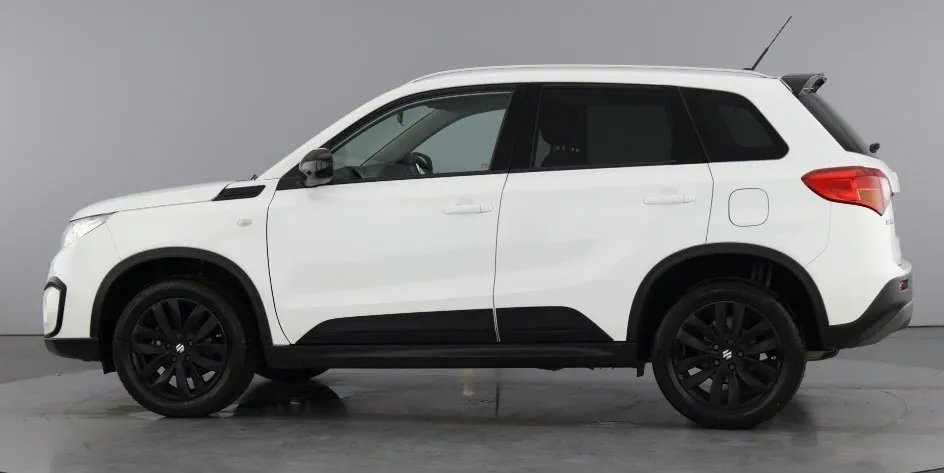

By the way, here’s a picture of my baby.
