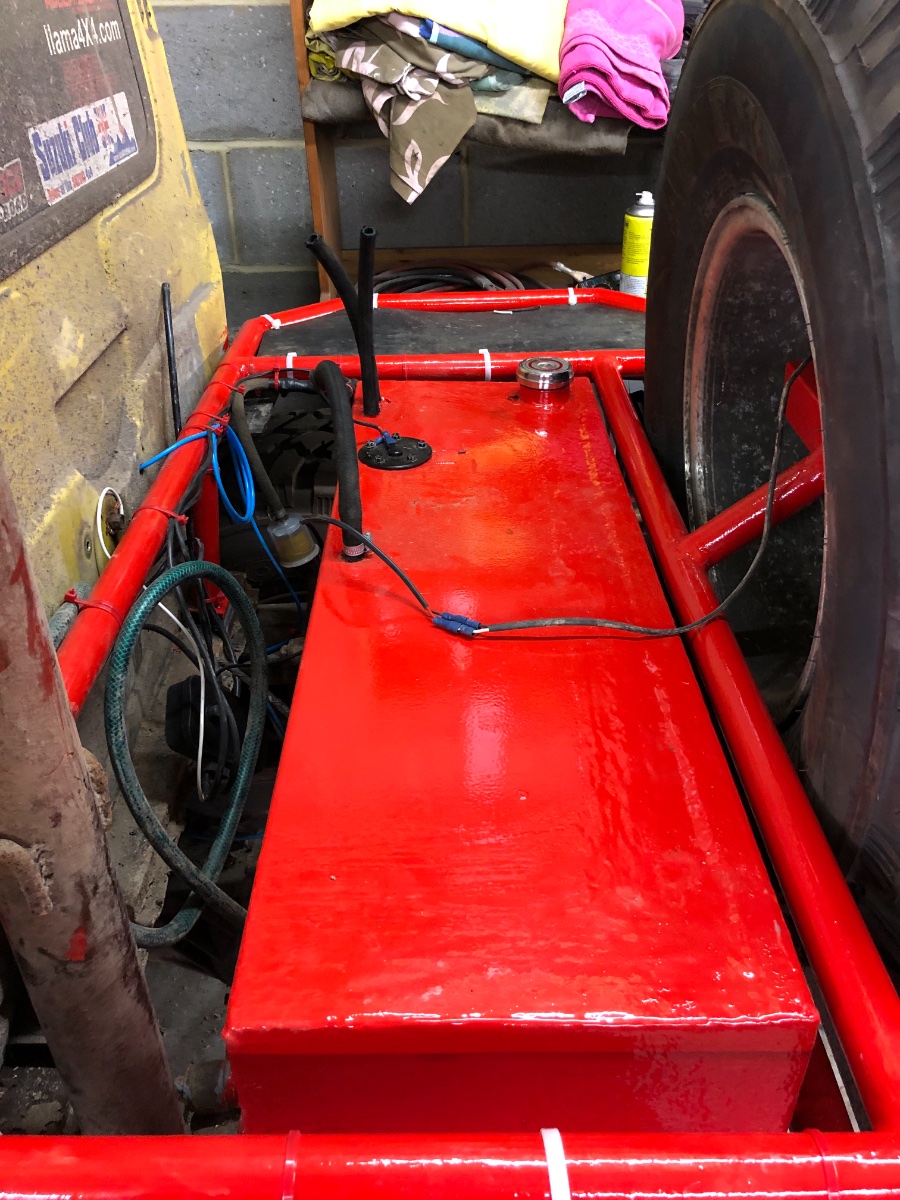

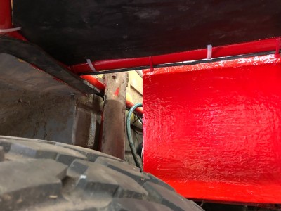

Jordi that is feckin' brilliant. I would have used P clips instead of manky cable ties though...
- Posts: 3859
- Location: London
It wouldn't be the Jordiemobile if it wasn't just a *little* bit shonky...donkeychomp wrote: ↑Sun Mar 17, 2019 11:53 pmJordi that is feckin' brilliant. I would have used P clips instead of manky cable ties though...
Just like mine wouldn't be the same without a few choice dents/rust holes...
Cable times cost nothing though, compared to P clips and its only temporary permanent
- Jordi
- Posts: 7531
Cable ties don’t need holes drilling either.

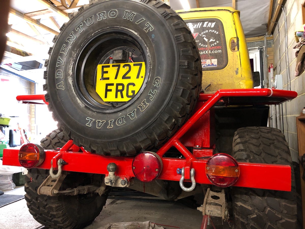

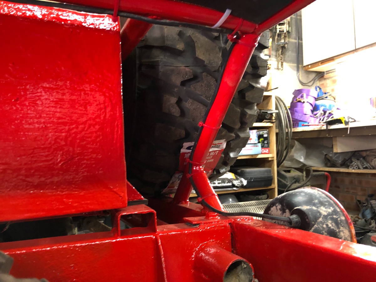

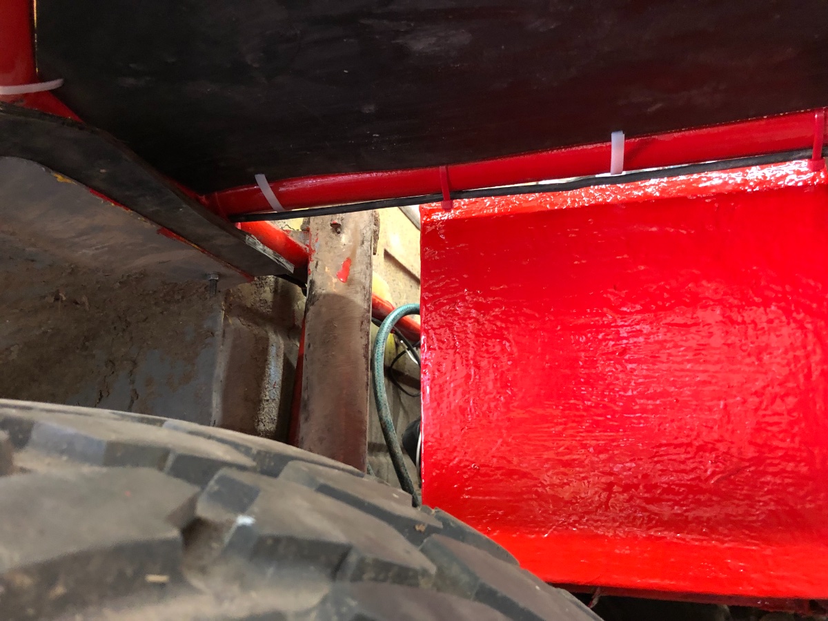

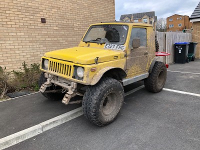

Looks very similar to last week but done quite a bit of tidying and plumbing work.
Fuel tank is plumbed in and it sucks the fuel through properly, does need new fuel lines fitting.
Cable tied 99% of the wiring and pipes into place, last couple still to do but didn’t have the right size drill bit to bolt the junction box to it. Thats on order too.
The battery is knackered, tried charging it, no joy. New battery ordered.
- Jordi
- Posts: 7531
Had an issue with the headlights being constantly on, 99% sure that was a dim dip relays issue. Disconnected it and everything seems to be working fine.
New battery fitted. Started first go, oil and filter changed. Brakes bled and checked over.

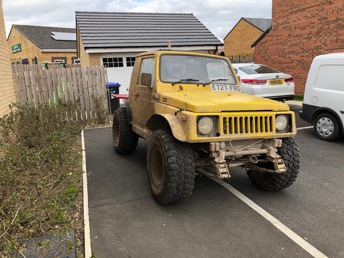

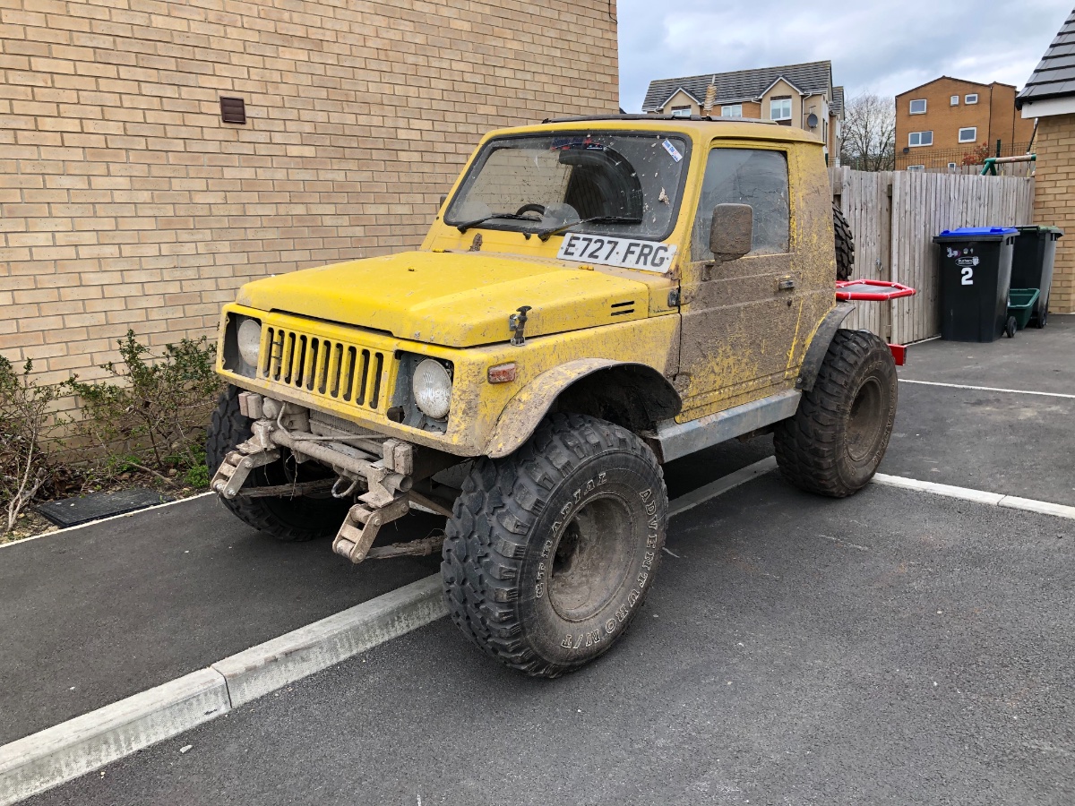

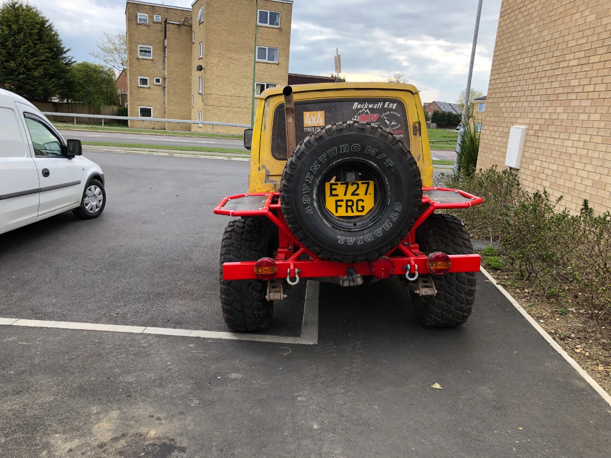

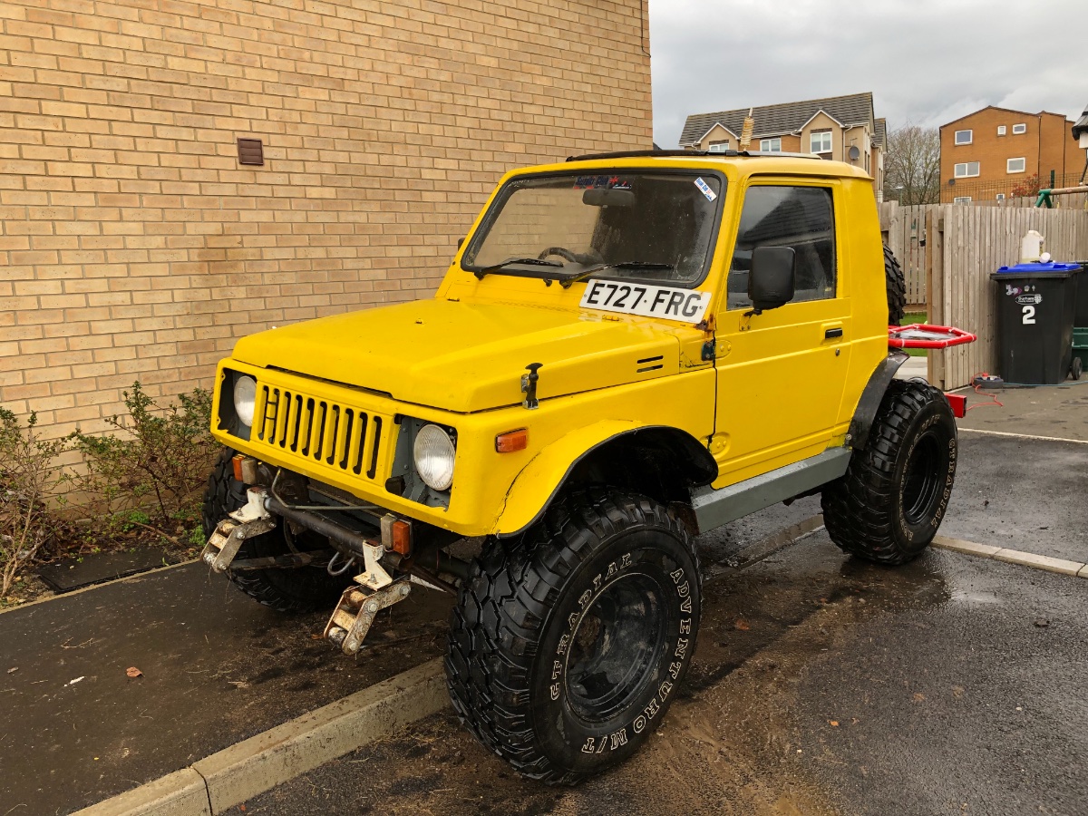

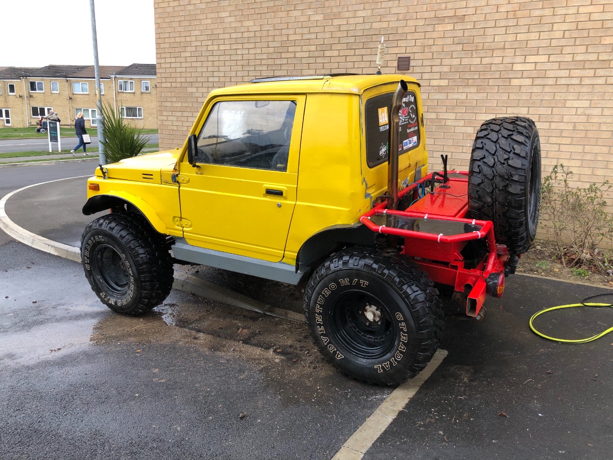

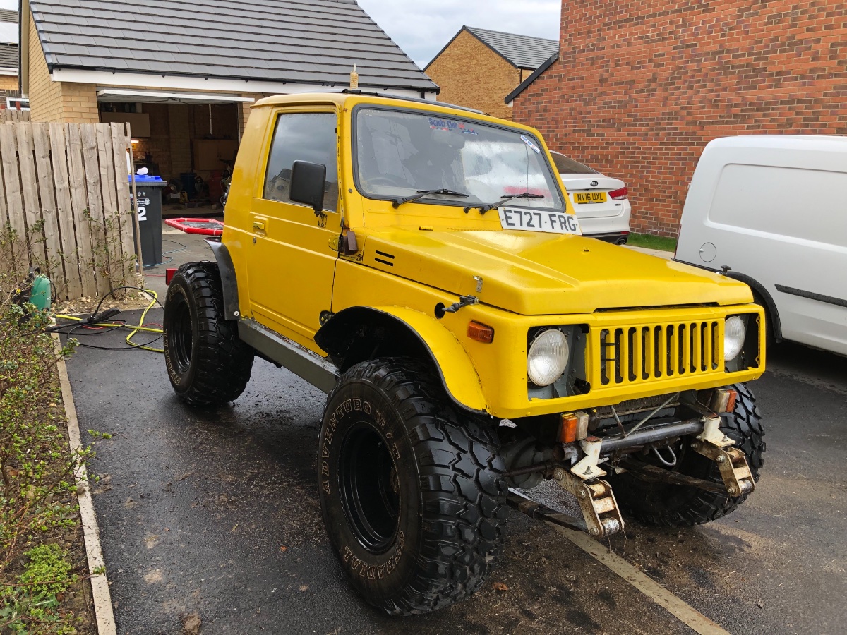

Quick rinse down.
- Posts: 3859
- Location: London
That's too tidy. Stop embarassing us! (by "us" I clearly mean "me"...)
Got an MOT yet?
- Jordi
- Posts: 7531
Depending on work. This weekend or next weekend.
