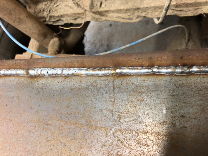

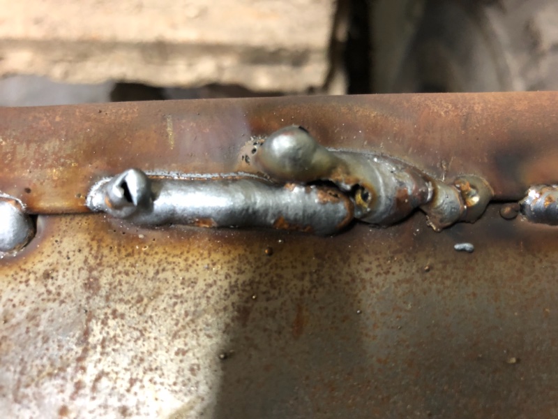

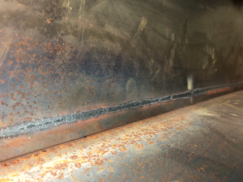

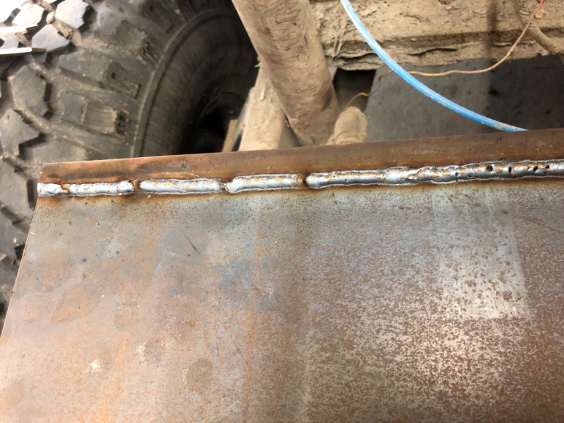

Welded the long seam on the tank. Tested it on scrap first, set the welder up. Few test welds. All ok.
First 2” of the seam? Like a pterodactyl with diarrhea shit on it from a great height.
Rest of it welded ok, good penetration right through the sheet. Messed with the settings a bit, also gonna take some of Adams advice and spend more time cleaning the steel first.
Is it gonna be air tight? Dunno, the ends caps need a slight skim on one side before they will fit, just a touch too big.

That looks pretty good to me - could you run a little JB weld or something over the top to aid in airtightness?
- Jordi
- Posts: 7530
I’ll get it all welded up and pressure tested. See how good / bad it is.

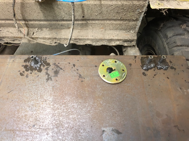

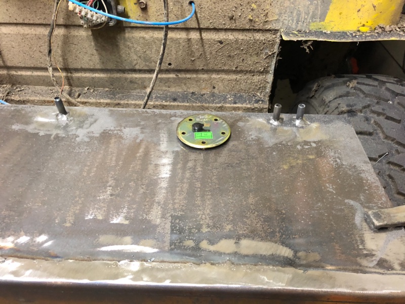

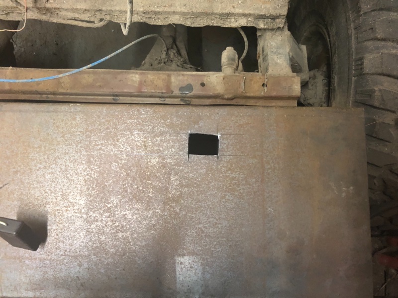

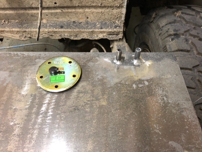

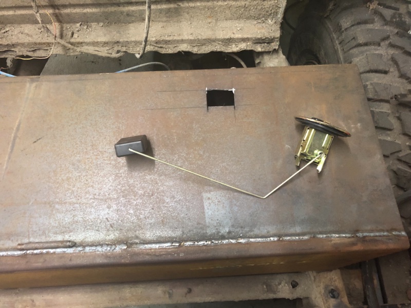

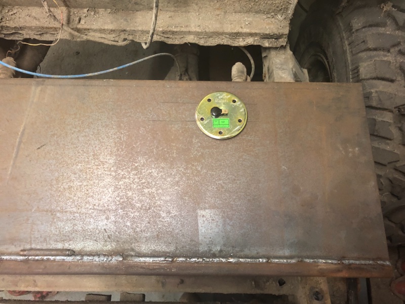

A bit more done to the tank. Hole cut for the sender unit and a pick up, breather and return fitted.
- donkeychomp
- Posts: 3583
- Location: Shepperton, Middx
That looks very good mate. Is it the same size as an SJ tank?
- Jordi
- Posts: 7530
Off the top of my head i can’t remember the volume, it is bigger than standard though.donkeychomp wrote: ↑Sat Apr 28, 2018 9:20 pmThat looks very good mate. Is it the same size as an SJ tank?
