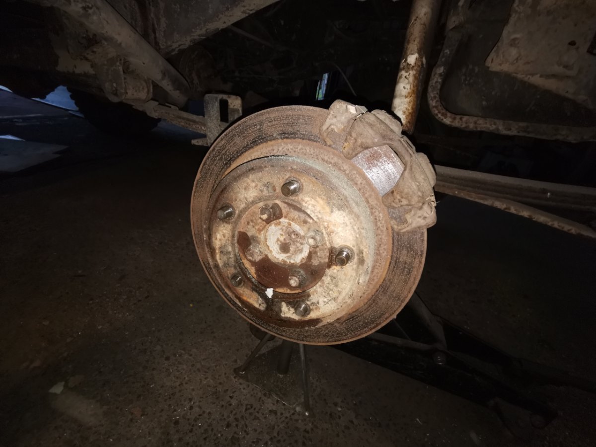

Just got this SJ 410, It has had rear disc conversion at some time, Cant get in touch with the PO to see exactly what he has done.
I have read that front callipers can be used for this but My problem is the Callipers on the rear are different to the ones on my front which are the Origional ones. , and I need to change the discs and pads on rear so not sure which to buy.

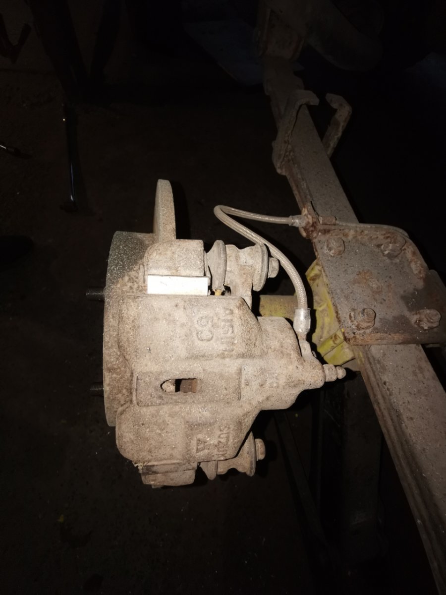

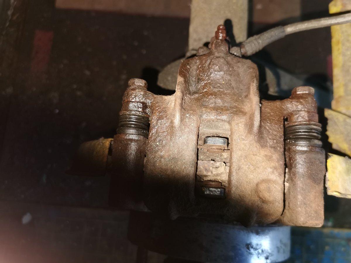

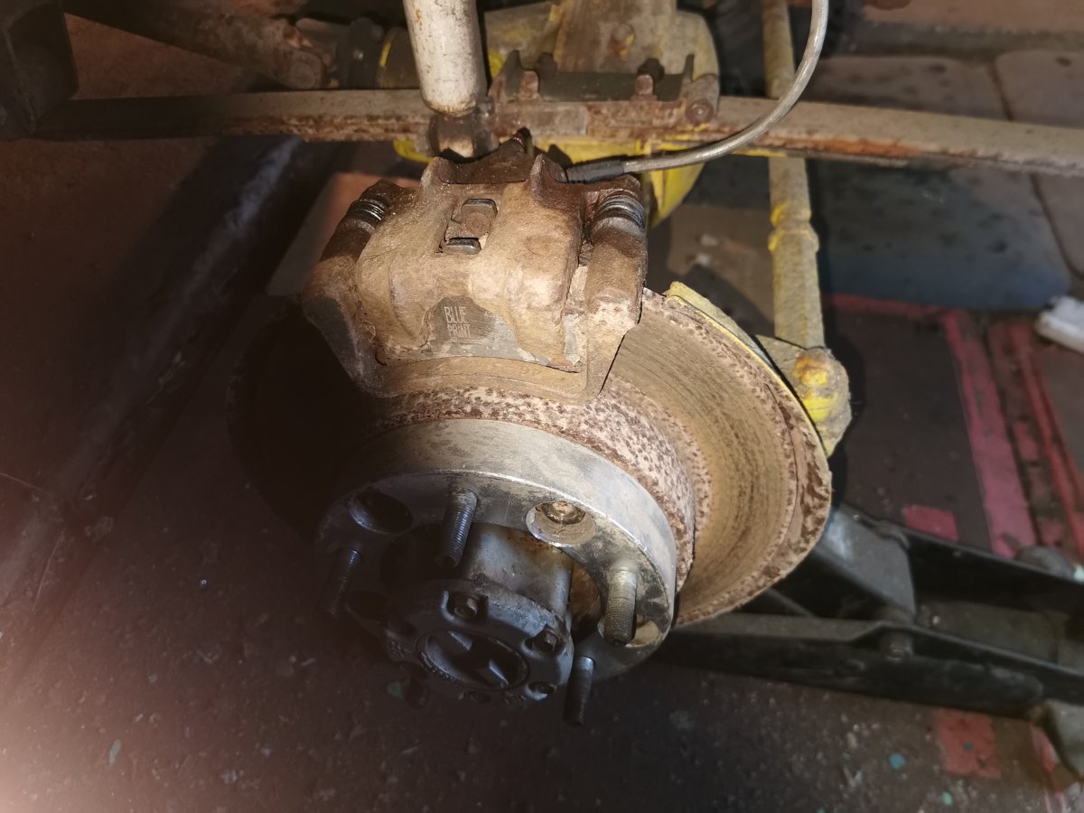

First 2 pics are original on front. Second 2 are what he has put on rear. they are Sazuki and have number 53 on them.

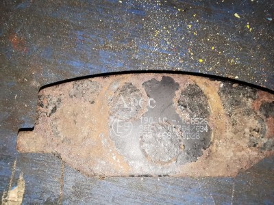

Last pic is pads that were in them.
Anyone know what they are off and what discs and pads I need to fit with them ?

Looks like a standard Aisin japanese built SJ caliper and pad.
Suzuki used two different calipers. One for the Japanese built and one for the spanish built.

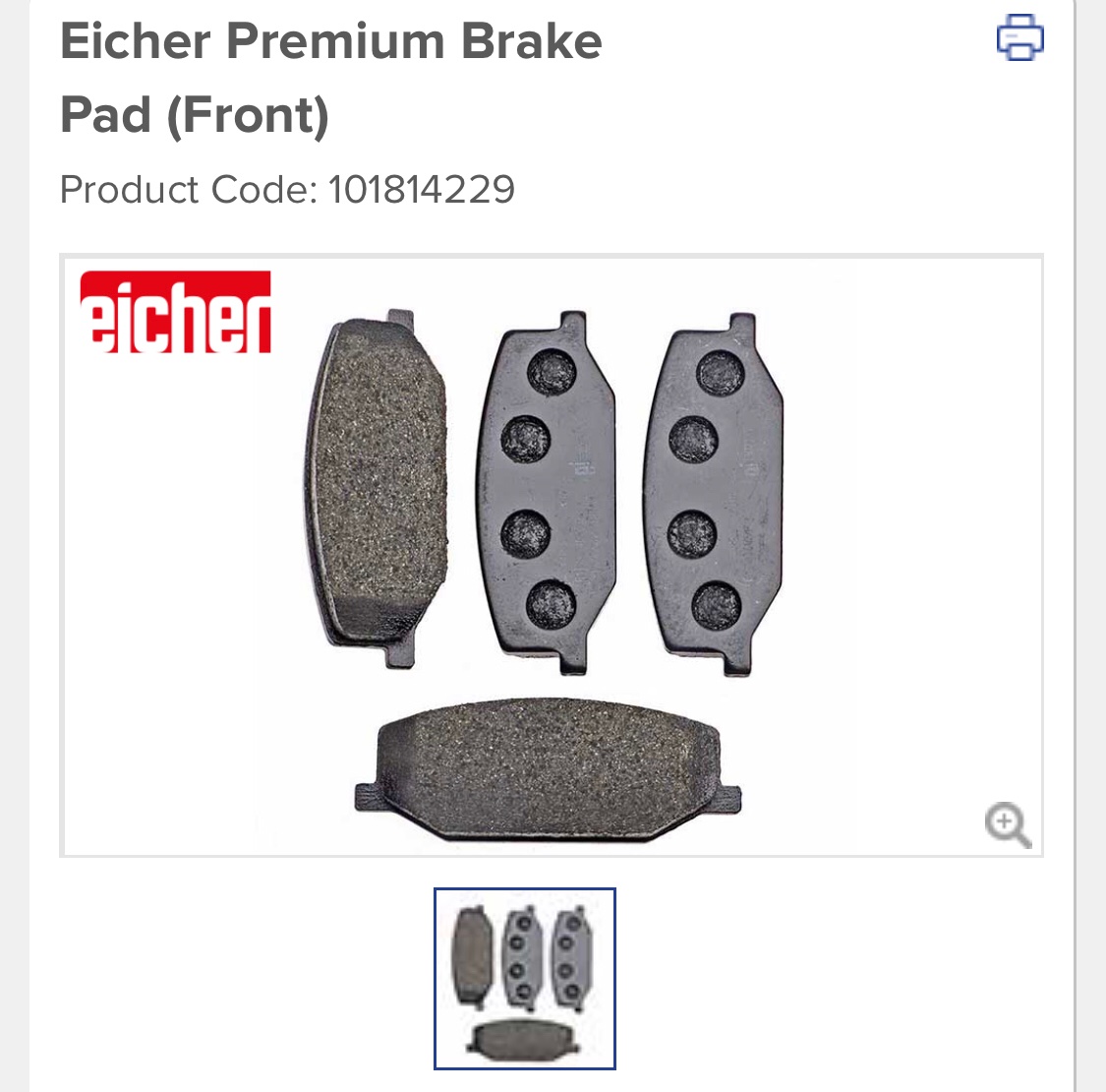

So do you know which discs and pads to order for the rear ? actually the discs do look the same as the fronts, just different callipers.
- Jordi
- Posts: 7540
Re: Rear Discs
Euro car parts

Just a quick question. Will the standard front discs fit on this rear conversion, with these pads ??
