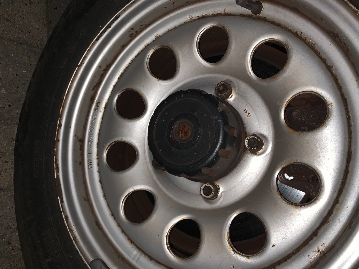

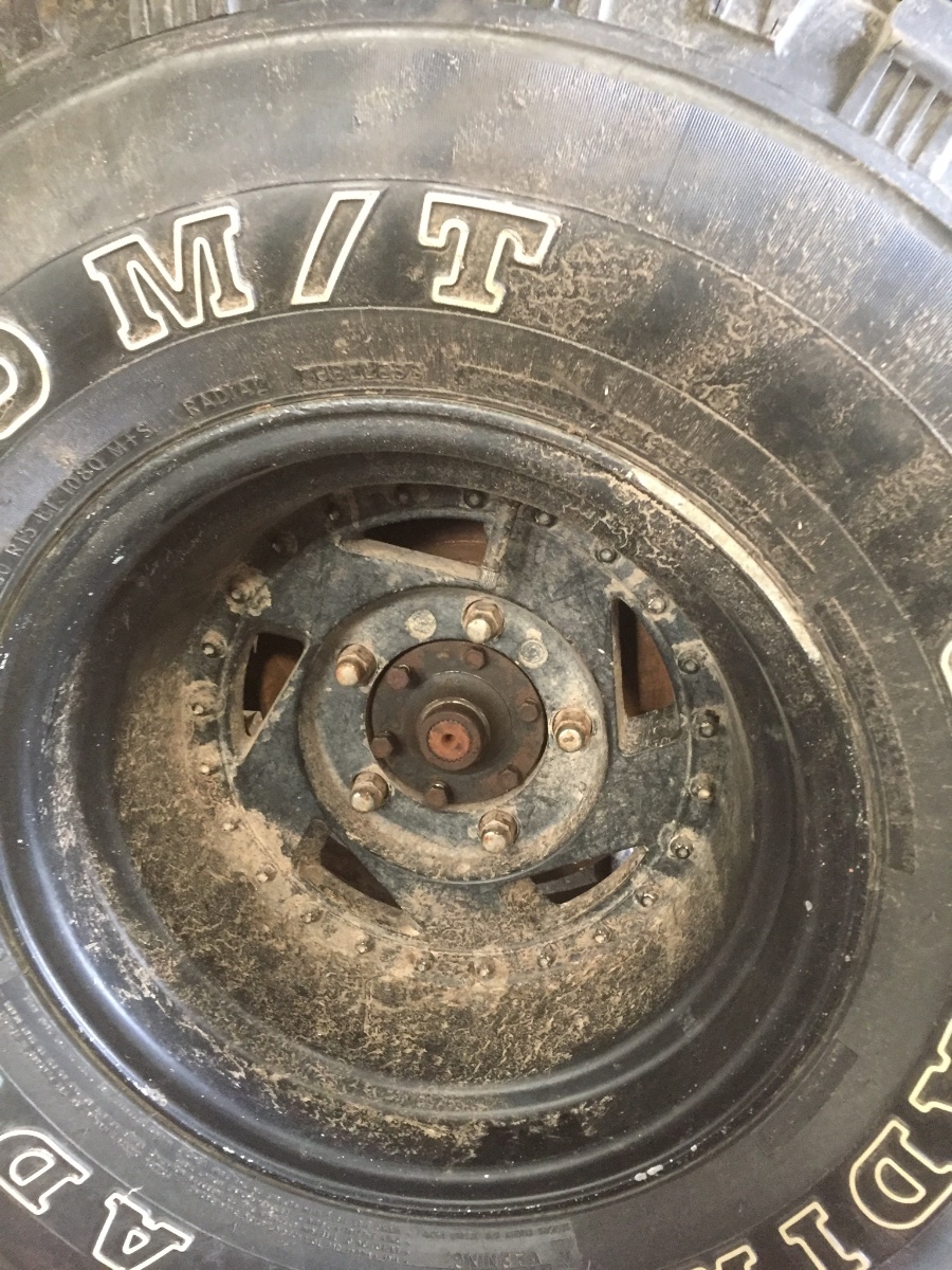

Hopefully I've managed to attach some pics of the manual and the hubs. The manual sounds as if the manual locking hubs were the optional extra rather than the "autos'. No idea to be honest.

Thats just a plastic cover over a fixed drive flange.
Undo the bolt and there will be a drive flange with 8 bolts iirc, a small domed cap over the end of the half shaft.

This is a fixed drive flange without the little domed dust cap over the end of the half shaft.
If you take that plastic cover off thats what you will probably find under it.
