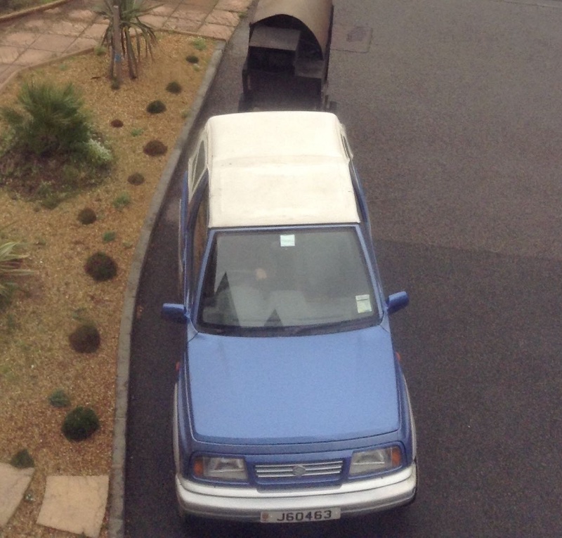

This is the vehicle
can any one tell...98 0r 99 Model?

Dont spend too long looking for an OBD2 port as im pretty sure the old vits didn't have them ;)
