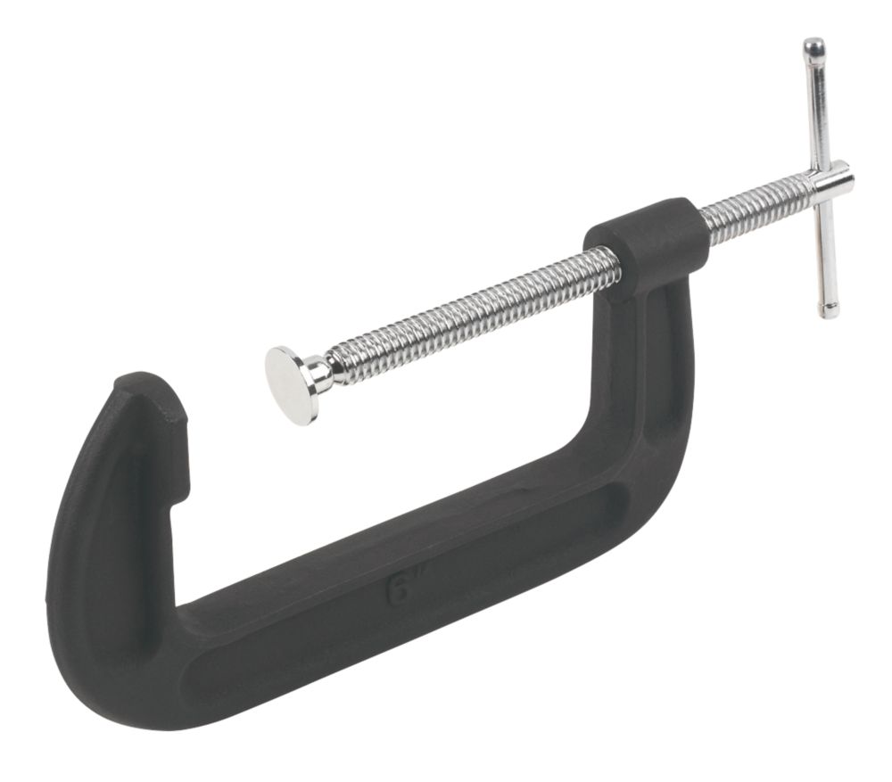

Also get some g-clamps to hold the spring pack together. You only need one, but 3 made it much easier!
