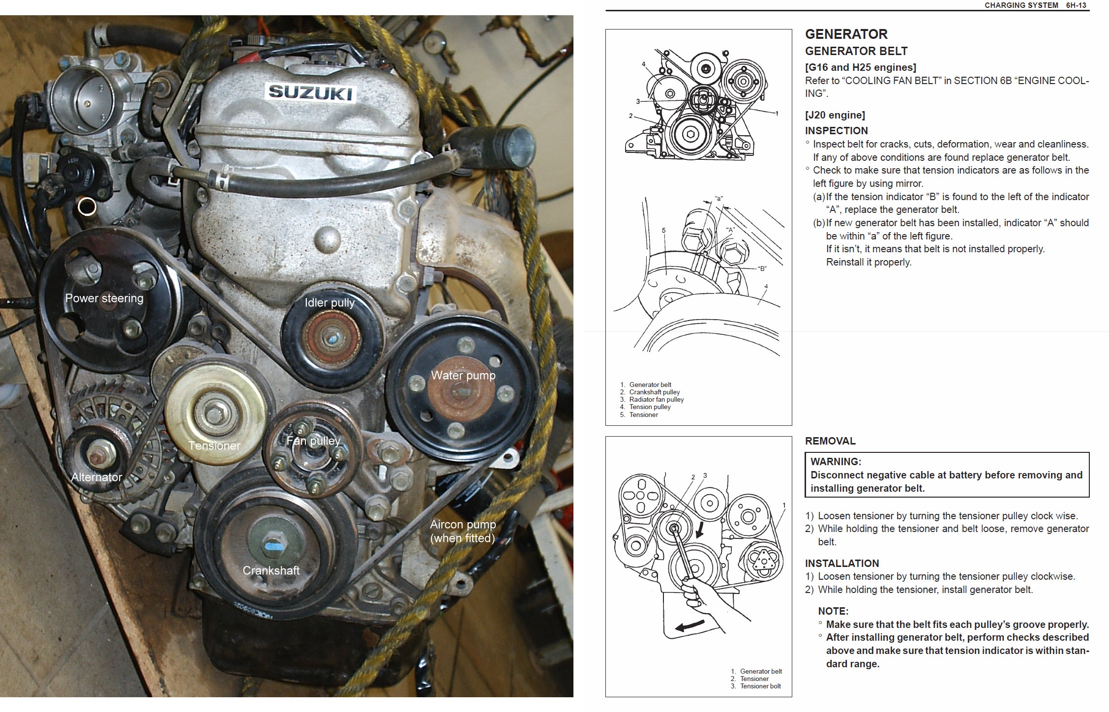

Tension info - although you know this anyway!
I've had a search to see If there are any torque values for the tensioner but have found nothing.
As you have a new belt I'm afraid I don't have any suggestions.
- J20 engine generator belt.jpg (657.49 KiB) Viewed 9407 times

re: "Lubing pulleys", I was having a chat about it with a mate who's a mechanic and he suggested lubing the pulley bearings. I took belt off while I applied a small amount of WD40 to all of the bearings shown in Darrell's photo (apart from the crank), and took some care to make sure that none ended up on belt tracks or belt, and cleaned off excess before starting. I suspect that a little may still have ended up on belt, but it's not squealing any worse than it was before (at the moment).
