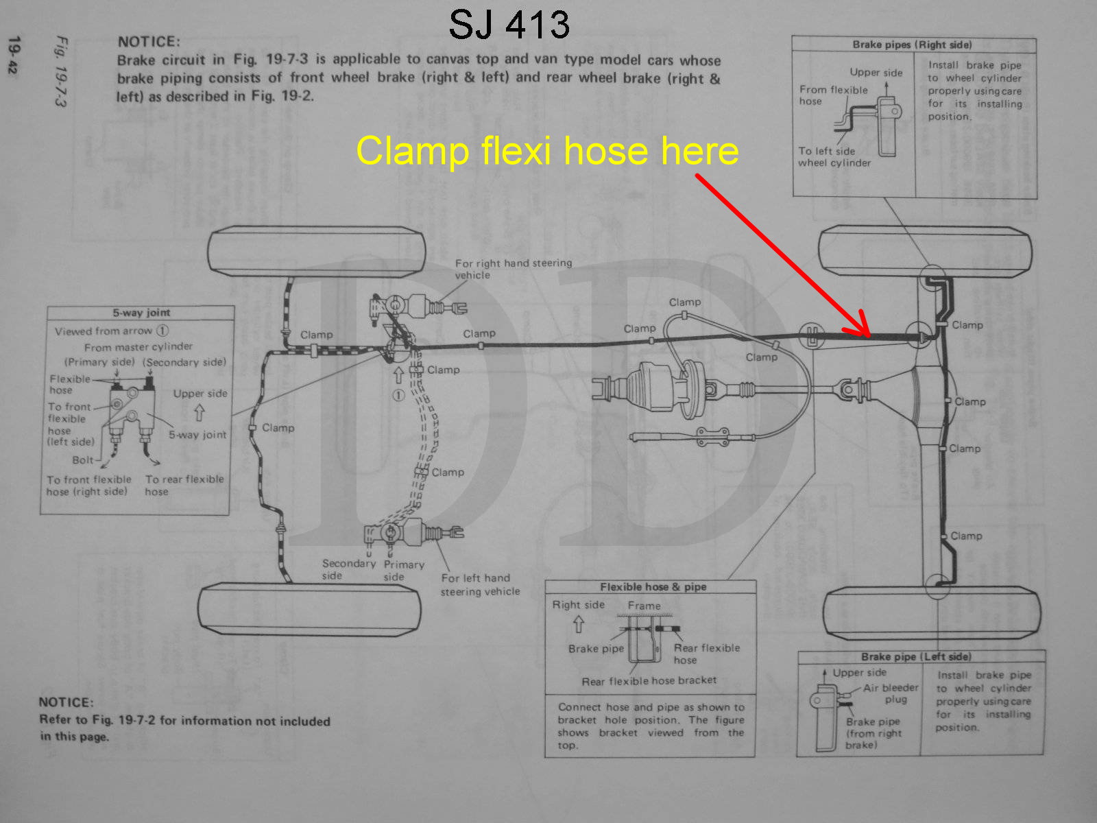

Got to change the offside rear wheel cylinder on my sj413 samuri......is there any way to stop brake fluid being lost in any great amount its a cylinder with 2 pipes going to it..... on my old escort i would put a plastic cover over the master cylinder and secure with a rubber band.....would this be applicable on the anus ????...a bit difficult to clamp up both the rubber brake hoses going to the cylinder.....
any thought welcome
jim
Re: BRAKE FLUID LOSS ???? on sj413
Post by ScottieJ » Mon Aug 11, 2014 8:54 am
Two pipes? There's usually a single flexi from the chassis rail to the axle that then joins to a hard line running into one drum then across to the other, you aren't looking at the handbrake cables are you??
I just clamp the flexi to minimise loss, the system will need bleeding still though.

Some 413s did have twin flexis.
The replacement axle I bought for my kja had two flexis
And a bleed nipple on each cylinder. I removed it
From a e reg jap.
The kja has the flexi coming down on the left side compared
To the normal sj style of being on the right.
Post by Darrell » Mon Aug 11, 2014 7:43 pm
This sounds your layout, one flexi , two pipes on first cylinder.

Darrell wrote:This sounds your layout, one flexi , two pipes on first cylinder.
Thanks that's a good bit of info for me to use
