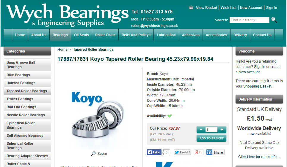

Re: front diff bearings
Just the 2 larger taper bearings are £80 each for a branded make
The kit from Auz is not much dearer than one bearing (not including P&P)

Hi twiss that's not a problem, I work in a HGV workshop so we've got the tools to do it,
Hi Darrell, yeah I couldn't believe the cost of the bearings as well, looks like I'll be ordering the kit from AUS. Thank you both for replying.
