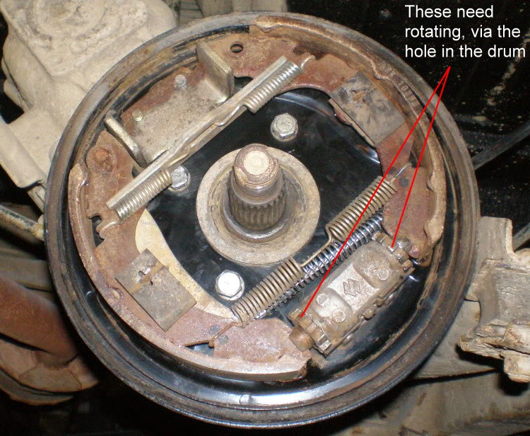

I need to adjust the the shoes on my transmission brake how do i go about this..a picture would be great....

Have a shifty here http://forum.suzukiclubuk.co.uk/vi ... =12&t=2793

Okay i think there is 2 adjusters on this picture not very clear....is it a screwdriver job ????
jim
Re: SJ 413 TRANSMISSION BRAKE
Post by Darrell » Sun Mar 30, 2014 10:59 am
Yes a screwdriver..

Thanks thats a good picture...explains it all......they are the original shoes but as they only are used for handbrake hopefully still servicable anus is 1986 60 thousand miles
