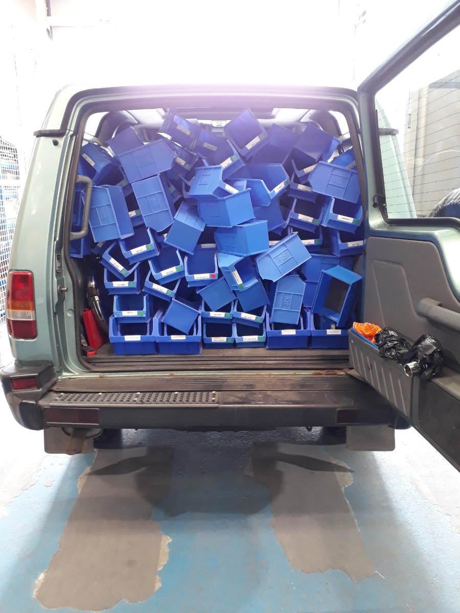

Also it's possible to get over 260 storage bins in one.

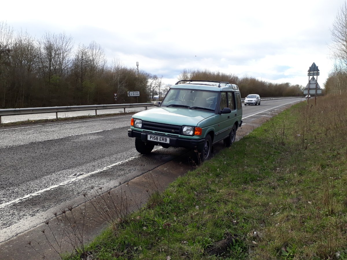

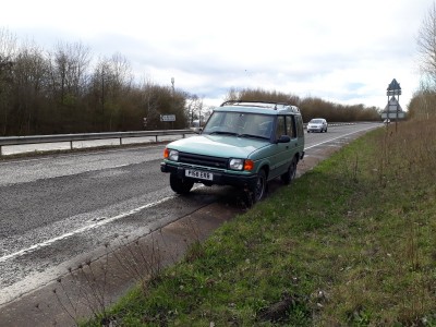

Hmm. Side of the road. Has it broken down...again? lol
Re: Andys dabble in disco land.
Post by andyrew » Mon Apr 15, 2019 8:24 pm
It was indeed broken down at the time in that last pic. Got me to the workshop tho, it was sucking in air about the fuel pick up pipe inside the tank.

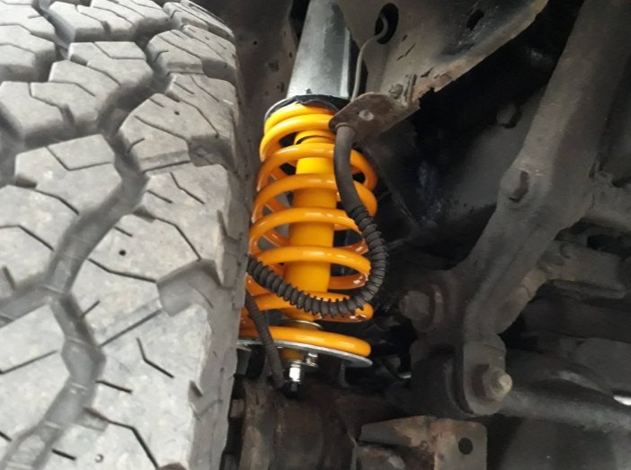

The blue discovery basically got picked for parts and will be probably sold or scrapped later this year. The green discovery has trundled around fairly reliably. It was only when sorting out some of the known issues for an upcoming MOT did it put up a fight. The whole underside of the car had been Schultz many years ago and there's one thing I've learnt over the years and that's if you want to properly fuck a car up. Cover it in schultz. It will rust everything out as soon as it drys out.

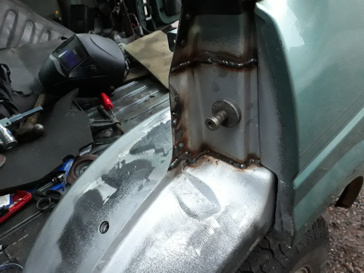

The disco recently recieved all new suspension, bushings bolts and ball joints and some substantial welding. New spring mount plates and strut towers, and one jockey arm was to be replaced after a nut ceased on.

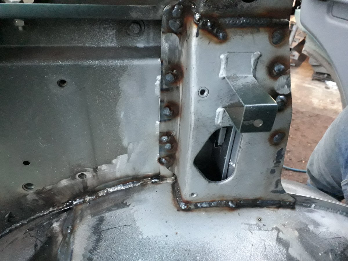

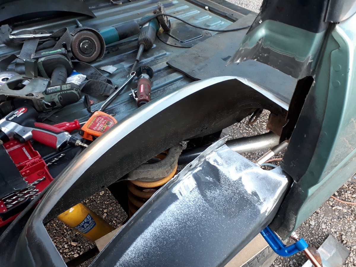

Welding.

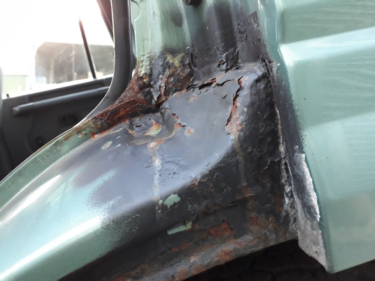

Discos are notorious for rot. The c pillars and rear archs are a common place.
The rust goes between the quarter panel and inner structure. So I decided to chop the lot out higher up. Repair the sections individually then weld them back in.
Used an of the shed inner wheel tube repair section and chucked on a new wheel arch panel aswell. Repeated on the other
