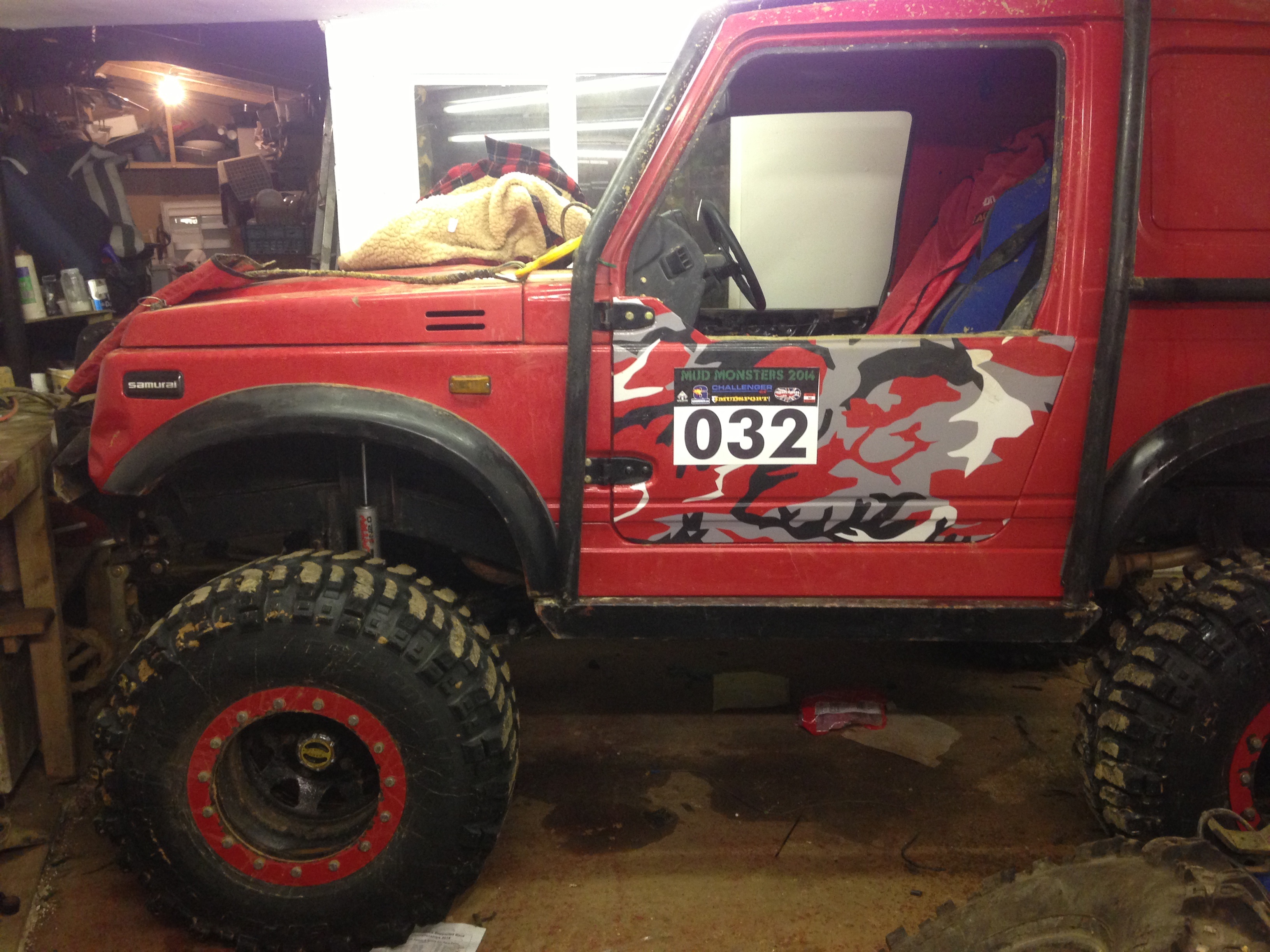

Post by mike harris » Wed Mar 05, 2014 8:13 pm
Sat up the end of the garage cast aside :(
Post by ROBBIE » Wed Mar 05, 2014 9:13 pm
Poor dejected little monster
